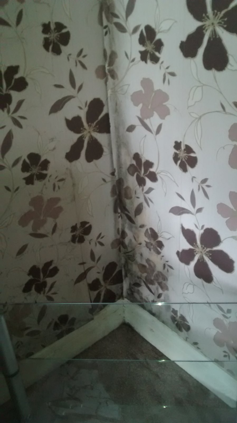

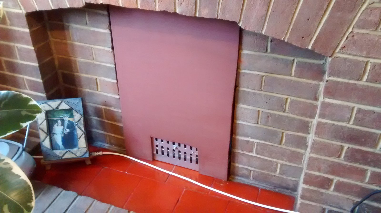

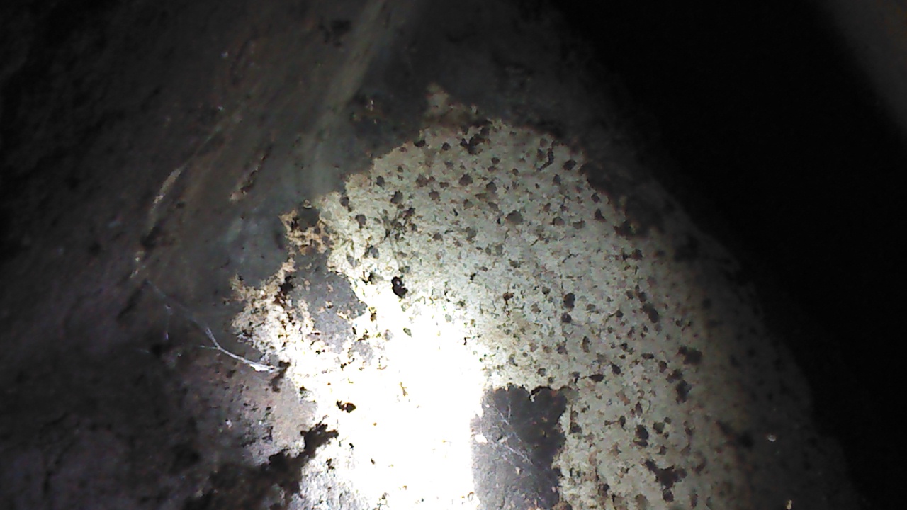

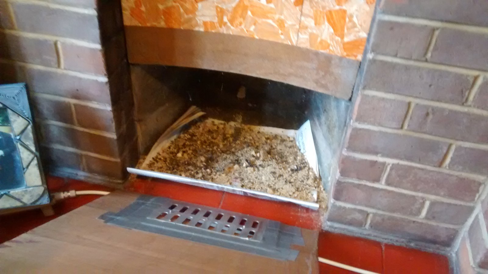

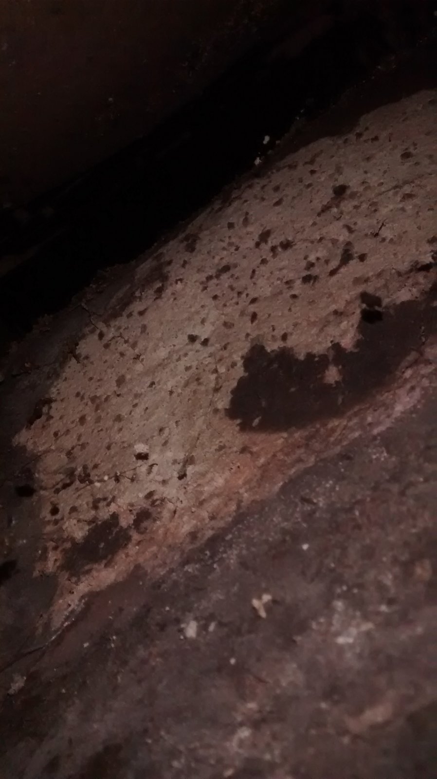

OK, so I am in my new home - a 1930s bungalow. As suspected, there are signs of black mould around the house. I suspect that this is due to lack of ventilation rather than water getting in though, as there is no mould near windows, chimneys, ceilings etc. Its all in corners and edges of rooms where there was furniture. The house has limited ventilation, with just an extractor fan in the shower room (nothing in the kitchen). There is also no radiator in the kitchen or the hallway area. The lounge has black mould in the corners either side of the chimney (outside walls), The chimney has a panel with air vent, but I am thinking, would I be better off just removing that panel for improved ventilation? Also, if I got the chimney cleaned (I just looked up there, does that look normal, or is that some sort of nest????) would I be better off installing a quiet (ideally, silent!) extractor fan that can just extract all the time, onto that panel? I suspect that the previous owner, who was about 80 years old, used to keep all the windows closed to stay warm, and the kitchen door open get help get heat into it. Also, her oven was broken, and she was using an electric hob, so probably a lot of pans on the boil too! Oh, and no trickle vents on any windows either.

Every disused chimney flue needs to be ventilated top and bottom. Preferably a ventilator that does not have the facility to close it.

Mould behind the chairs and in the corner, is normally indicative of cold walls, and not enough heat and ventilation. It'll depend on your budget as to how you deal with the problem.
I assume that pumping up the heat to keep it dry is the obvious solution?
Often, but not always; in a lot of cases, it's the lack of air movement that causes the mould issues. If you've got brick walls without a cavity, then they will always be cold, and as you don't have the heat on permenantly, they will get cold overnight.

Had our first slug last night! Only saw it when I opened the lounge door which ran over it. Looks like it came from the chimney, the slithered all round the edge of the sofas towards the doorway, I guess hunting for food towards the kitchen.
Maybe the damp musty smell up the chimney was slugs? Running the dehumidifier in the room, still have fire place open, and windows on catch, humidity still at 55-59 with people in the room. Wondering if the chimney is a problem? Will be removing it eventually to make a bigger room.
