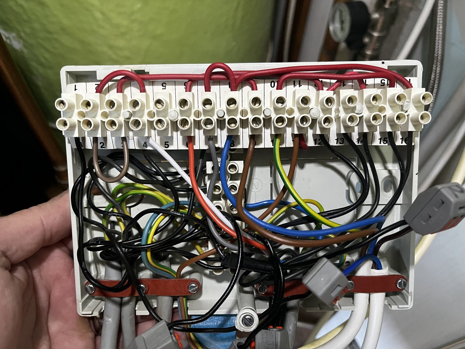

Just installed my Nest 3rd gen on our Y plan heating system. I wanted to keep the thermostat in the same place so I decided to wire the heat link into the wiring centre (I’ll put a picture of wiring centre below before nest)

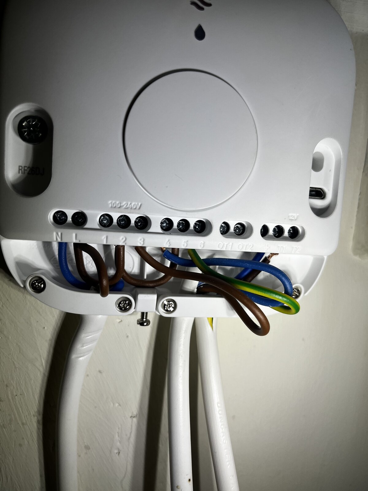

How I connected the heat link was;
L+2+5 = from fused 3a
Neutral = from wiring centre middle
wiring centre 8 to heatlink 4
wiring centre 9 to heatlink 3
wiring centre 10 to heatlink 6
in order to reuse thermostat wire I linked 2 & 3 and removed the black wires and placed these in T1 & T2.
as mentioned everything fired up and seemed okay until the hot water kicked in and overides it all.

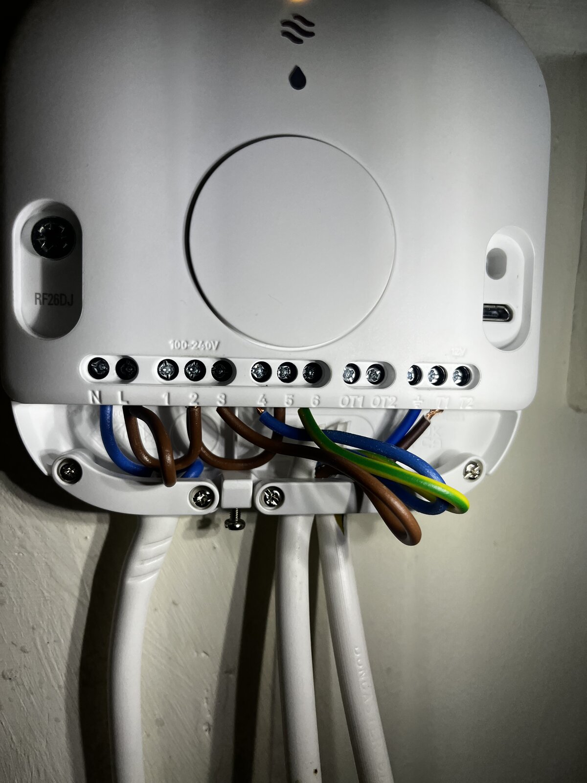

Could we have a picture of these connections as well, please?

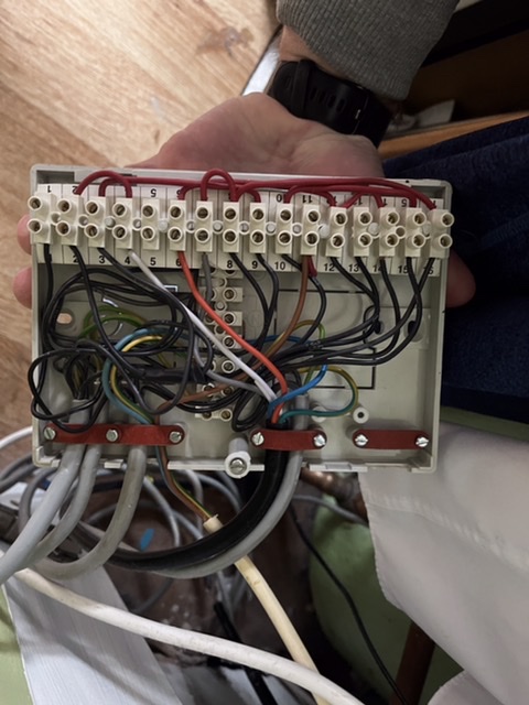

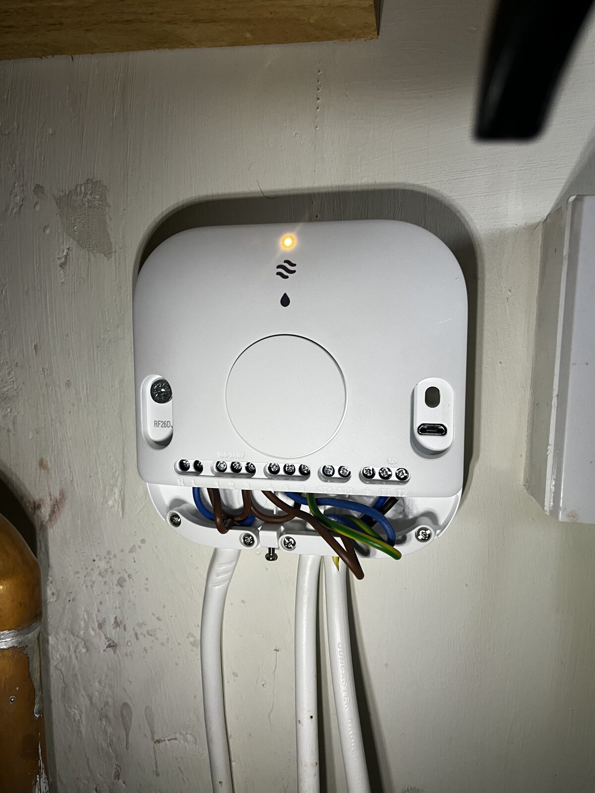

Hiya,
thank you for the responses.
please see pictures below. Please ignore the fact I used an earth cable for wiring.
just wired it again quickly to show
At a very (very!) quick glance, your wiring looks operative (excluding breaches of wiring regs, cable grips, oversleeving, Heat link requiring an earth when T1&T2 used, using green/yellow wire for a switched live etc... !).
To rule out a sticky relay on the Heat link, can you pull out and safely isolate the cable connected to terminal 3 of the HL, and see if the system goes to hot water only?
