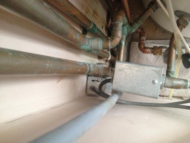

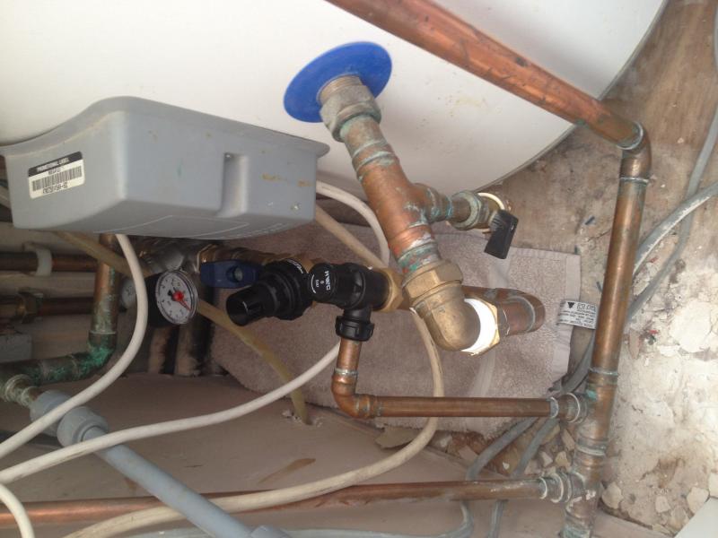

Can you post up some pics or video of the pipework and valves around the cylinder?
Here you go- sorry they are all 90 degrees off-kilter.
