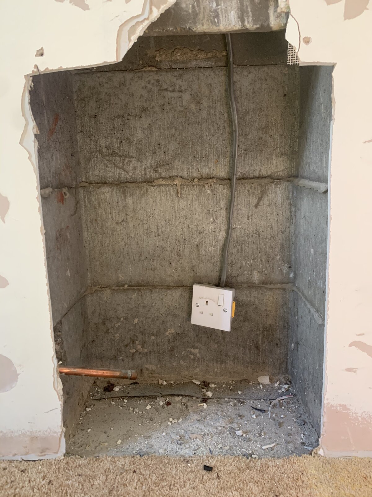

I recently removed my electric fireplace and we want to plaster over the hole that is left but there is a gas pipe that was put in when the house was built but never used.
Can the pipe be left where it is or does it need to be removed?
You really want to have the gas pipe traced back and capped at the branch point. Not best practice to leave an unused live gas line like that in situ.
As Madrab says, that gas pipe should be capped off where it tees off the main distribution pipe, or better still the tee removed altogether
Thanks for the replies, spoke to a British Gas engineer yesterday as he worked at my neighbours and he said it was fine. I would rather try to locate the other end tho to be safe having thought about it.
As far as the pipe is concerned then he's right, there's nothing actually wrong with it ..... buuuuuuuuut (and it's a big but) ..... best practice and safety dictates that you never leave a live gas pipe, capped off or otherwise, hidden behind anything and a BG engineer should be advising that IMO.
If that chimney's open then you should be taking care of that spur socket too
