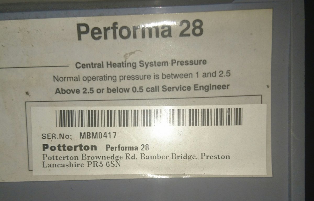

It's a performa 28. I have replaced the differential valve diaphragm this morning and the boiler is now firing up correctly, the diverter valve is actuating and pin activating the microswitch but outlet is cold......
It just says performa 28 on the label.
