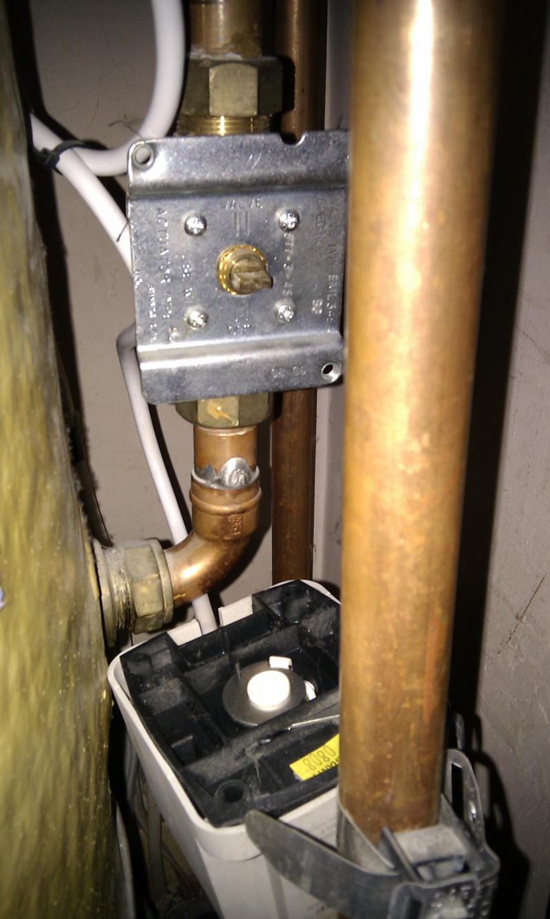

Hi Dan
I removed the motorhead and the screwdriver-like head underneath (is this the spindle?) is perpendicular to direction of flow. I can turn it fairly easily with my fingers.
Pic:
Both CH and HW values are Sunvic SZ 2301 units. There's a flushing lever on each one: when I move the lever on the CH valve and let it spring back, I can hear it turning the actuator motor inside; but with the HW valve (pictured) I can't hear it turning the actuator motor.
So does this mean that the actuator motor has burnt out? Can I just buy a replacement actuator?
If so, in the meantime should I leave the valve open or closed?

Hi all
A quick update. I've had both CH and HW actuators off their valves and I've tested that they both do turn on and off properly as the CH/HW/cylinder stats and programmer all require. So I'm satisfied that both valves turn freely and that the motors in both actuators are working properly.
However - although the actuators do turn on and off when they should, could they still be faulty? e.g could faulty circuitry mean one of them is still asking for the boiler & pump to be on, even when it's closed?
If not, I guess the frost stat is the most likely cause of the pump staying on 24/7...
Just a quick note to say.... Fixed!
I tested the frost stat with a multimeter and it was fine. So I tested the zone valves and turned out the microswitch inside the CH zone valve had stuck on. I replaced the actuator with a new one. Wired it back up carefully and all works great! It's been quite good fun working out how our CH system all works.
