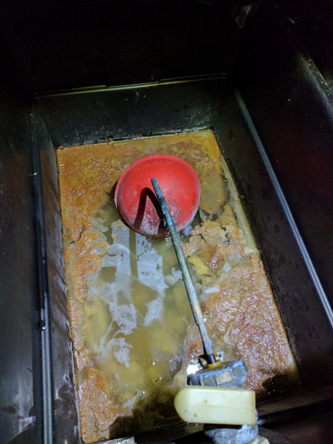

Hi guys,
I'd appreciate your comments on this.
TLDR; Is this bacterial growth? Quick clean out and bleach should fix? Maybe a biocide?
Usually keep the system well maintained. Six months ago drained and bleach cleaned the header tank (was generally OK, only had 2-3mm of sediment. Hadn't been cleaned by previous owner in 10 years).
Last week, put some more Fernox F1 in the header tank as thought it would need topping up.
This week, slight brown scum and faint white-ish residue which has no 'body' to it (i.e. you poke it, there's nothing 'there').

Looks pretty nasty to me. Can also hurt some people's skin.
I would be inclined to remove all the water from the F&E tank and clean it well.
Might be better to completely drain the system and put a cleanser in for the correct time.
Don't you have a lid on the tank and insulation around it?

Well fitting lid with insulation around the tank and on the lid itself too.
Tank was perfectly clear last week when I added the F1 to it.
When you say cleanser, so you mean something like Fernox F3, or biocide like Fernox AF10?

F3 and F5 are the Fernox cleansers.
But I am not very familiar with them and only use the F3 on an already clean system, when we are required to use a cleanser.
I use the sentinel inhibitor X100 and it never gives me that problem. I also use their X400 and X800 when I have to clean a dirty system.

I had similar issue after redoing my ch 4 years ago. I added AF10 biocide to header tank after cleaning it out and no problems since.

I have seen several similar postings on forums with this kind of problem. Mostly seem to be after Fernox inhibitor has been used. That is one reason that I use Sentinel inhibitor as that has never given me any problem. But there are many different senarios in heating water systems which make comparisom impossible.
What I can say though is that no heating engineer wants to be called back ( at no further charge ) to an F&E tank like the one pictured on this thread just one week after it has been treated with an inhibitor.
So you have a strong concentration in the header - or did you drain some water @ a low point so the new inhibitor would get into the system and circulate ?
Yes, strong concentration as I didn't drain anything out of the system - was happy to let it slowly leach into the pipework as the volume of the water expanded/contracted over multiple uses.
Fernox say clean out tank, wipe with AF10 neat, then apply full dose of AF10.
