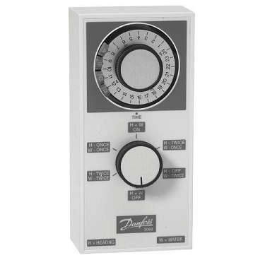

The Randall 3060 is a timeswitch / programmer that only provides on / off time control. (not a thermostat) However, if what you are referring to, looks something like below....
....then @ianmcd is right. Whilst they are robust, the manual mechanism wears and they become noisy, I've tried lubricating one or two, with little effect. I would normally replace it with a modern electronic programmer without any moving parts.
Whoops .. of course it's not a thermostat ... Haha. I've a lot to learn...
Thanks for taking the time to reply and help @ianmcd and @stem. .. yes it kind of looks like that but a little bit different
Would this be and ok replacement ? Or could you advise a cheap one to get.. also do you think it's a job I could do or would I have to call an electrician or plumber in? ..

The link you posted is a single channel programmer, which is for a combi bolier. You will need a two channel version with control of the hot water and central heating as the Danfoss does.

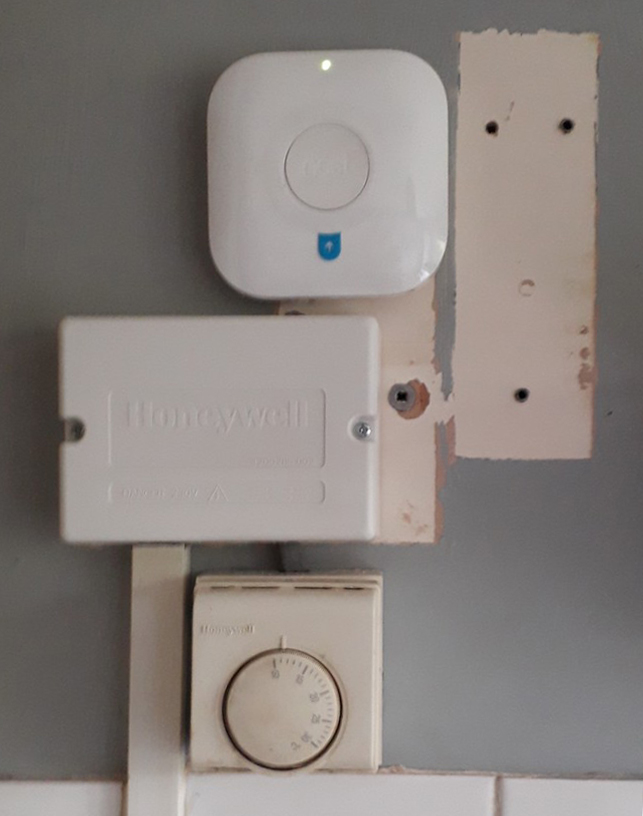

I fitted Nest Gen 3 not because I wanted to control with my phone, but I found in that nest of wires, there was only two wires going to boiler, and with Nest Gen 3 I could control both CH and DHW with two wires, my wiring down stairs in what is now a flat and was a garage became complex. This is how the flat looks now New_wiring_centre_etc.jpg there were far too many wires to fit in the Nest heat link so I used a wiring centre below it, in hind sight Nest was not the best option, but hind sight is easy.
So step one work out what you have, photos likely the best option, once you know what you have, then work out the final aim, and the route to get there.
