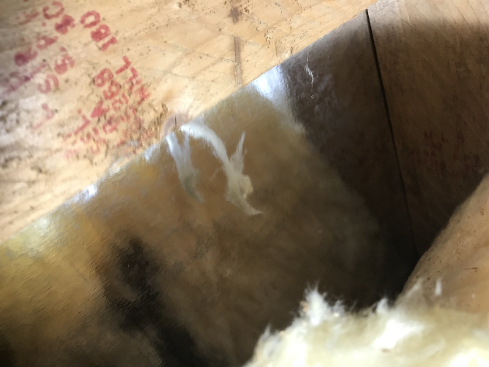

Tackled this recently. The original plan was to remove the original insulation but after starting the job we realised the original insulation was a mixture of a particulate insulation and sheeting.
Opted to keep it and used the Knauf king size space blanket. With it being encapsulated it was easy to unroll and manipulate. More expensive but Infound it saved time overall

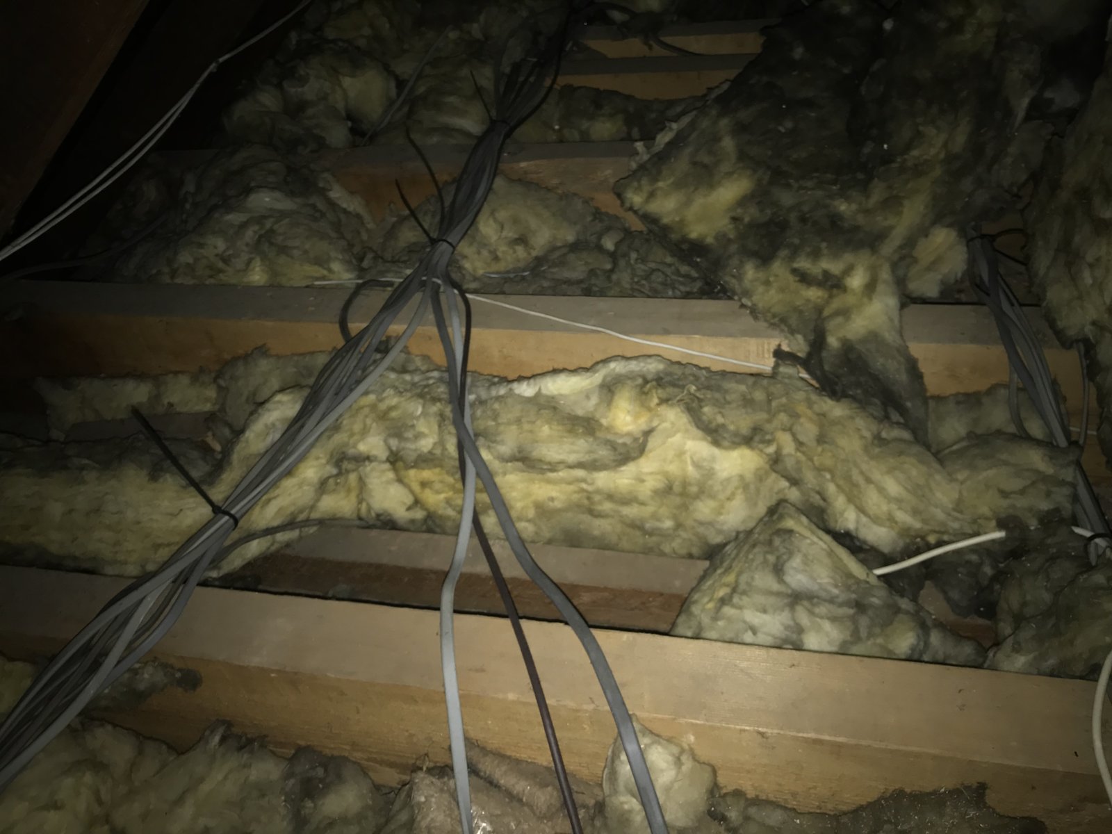

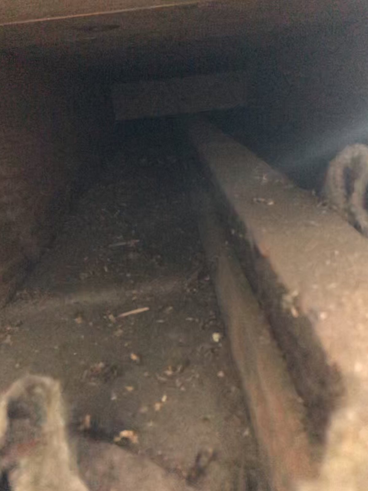

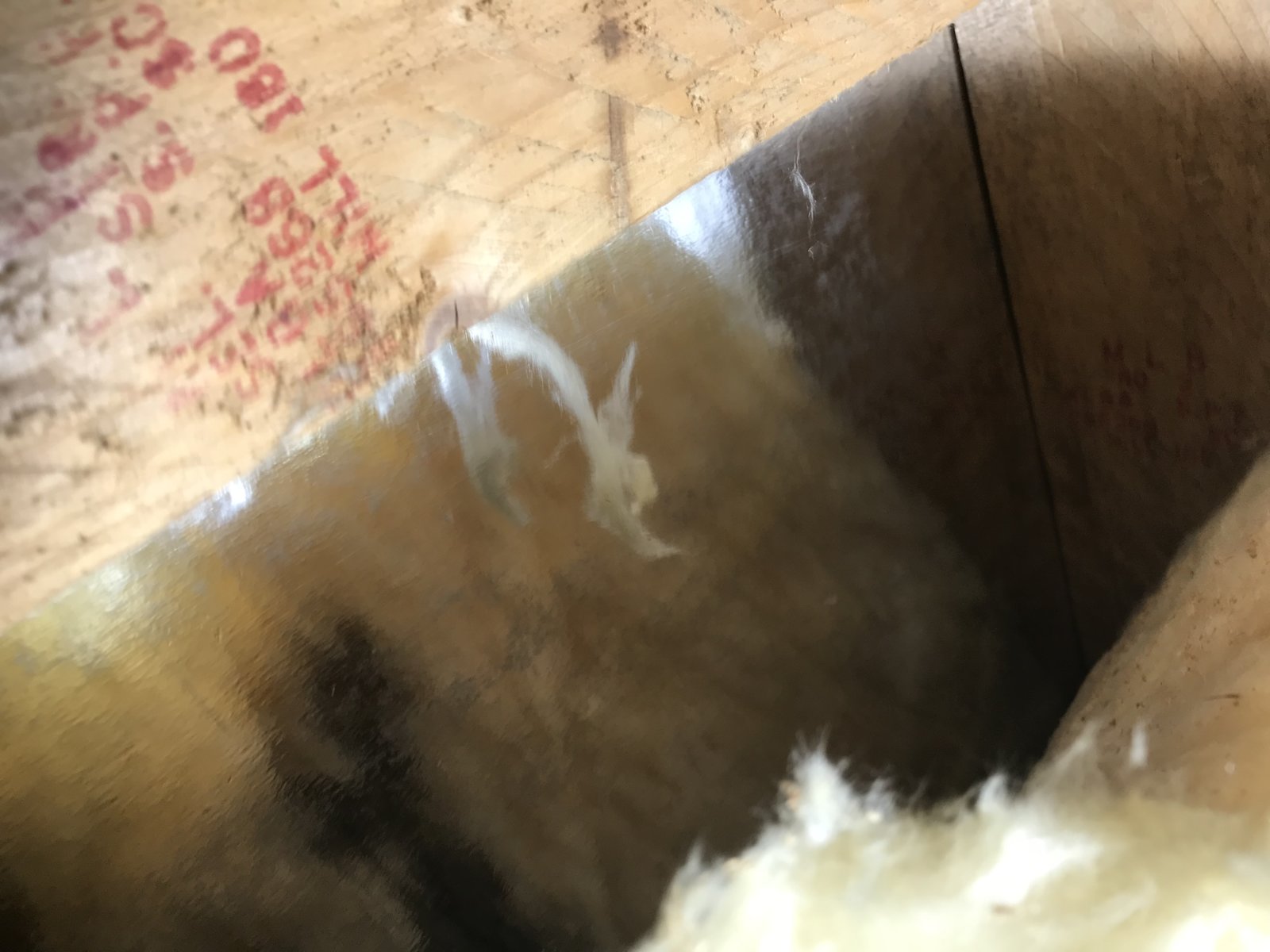

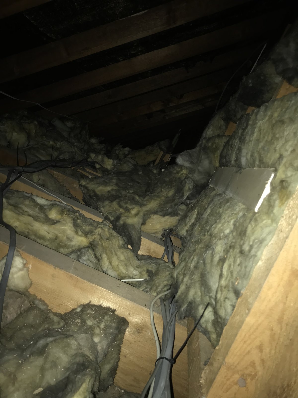

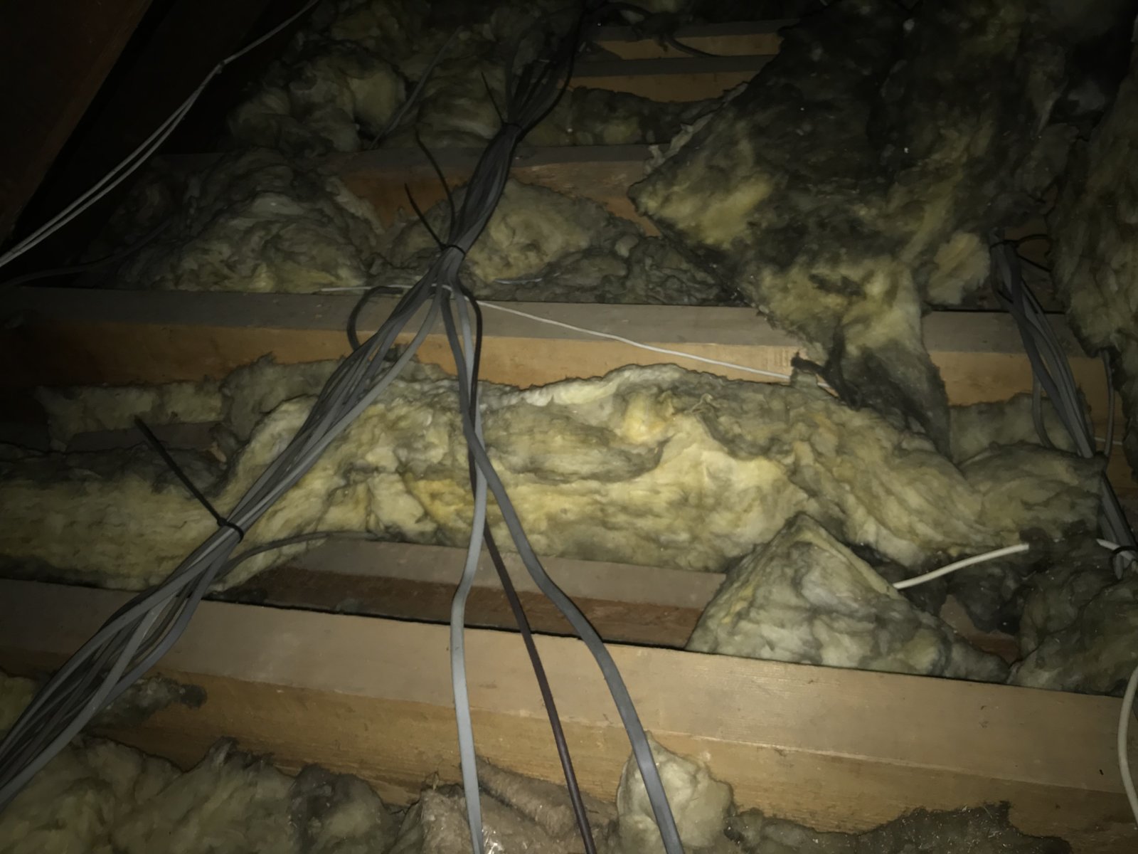

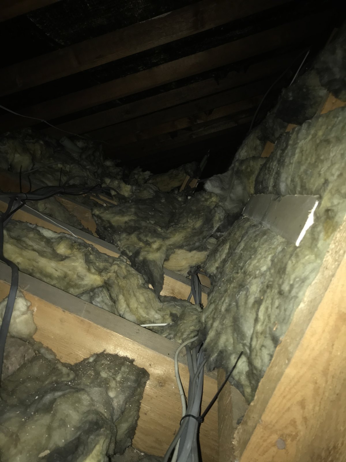

I am still in 2 minds to lift the current insulation, bag and take to local rubbish tip.
The dormer area is a tight fit and whoever laid the insulation has done an awful job - see pics.
Hoping to start this shortly... still undecided if I should remove the current insulation and start from scratch or lay over it?
If I am correct the original joists are 70mm depth, the joists which are set I assume from the dormer extension are 200m depth.
It appears that the original joist run in the middle(ish) of the new joists (which are spaced approx. 380mm apart). If remove old insulation and lay 200m insulation it would leave a 70mm void on either side of the old joist. Would this be OK or should I look to fill that aswell?!

With 200mm joists and another joist 70mm tall you'd only have 130mm above the centre, you could take a knife to the insulation and run a cut part way through the insulation along the middle of the ~380mm strips, that'll let you settle it down the sides and prevent it being heaped up or squished. Squishing it reduces the effectiveness.
I'd remove the old stuff. Arguably very little benefit keeping it and by removing it you get rid of many years of dust at once fell swoop. Ps, buy a dust mask if you don't already have one.

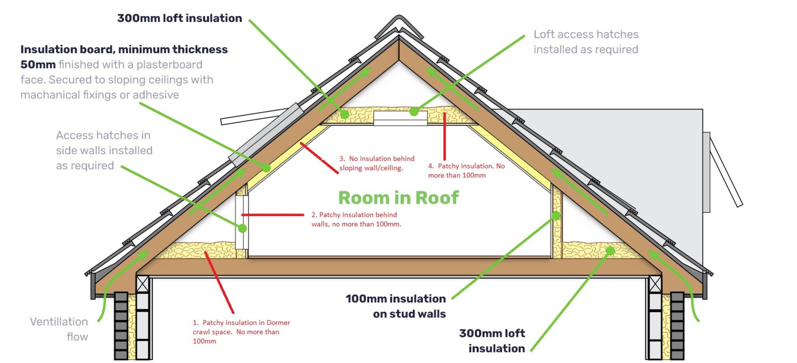

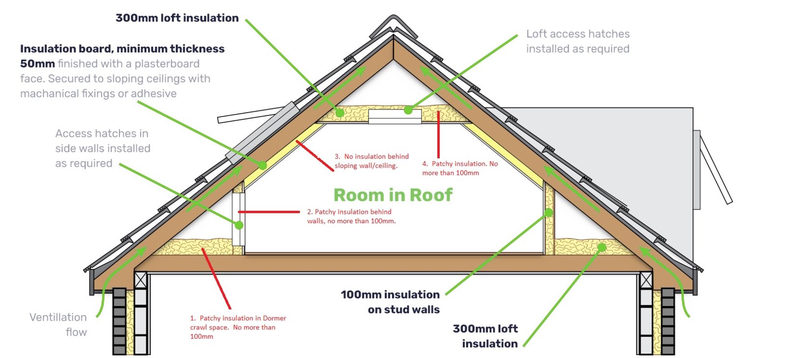

See notes in RED which I have added on to this example below.
My plan was to top up insulation (to 400mm) in areas 4 and then 1. Would I notice any real difference to this taking into account there are area's 2 and 3 that need to be insulated as well?
My plan was to top up insulation (to 400mm) in areas 4 and then 1. Would I notice any real difference to this taking into account there are area's 2 and 3 that need to be insulated as well?View attachment 179475
Some, area 1 will stop the eheat from downstairs escape out the roof, so it may become more snug but the upstairs room will still lose a lot through the walls.
Yes. I have a draught coming from some where in the rooms downstairs - in the area's to the side of the dormer so I am assuming/hoping it may be from area 1.
Main objective firstly is to stop heat escaping from downstairs.

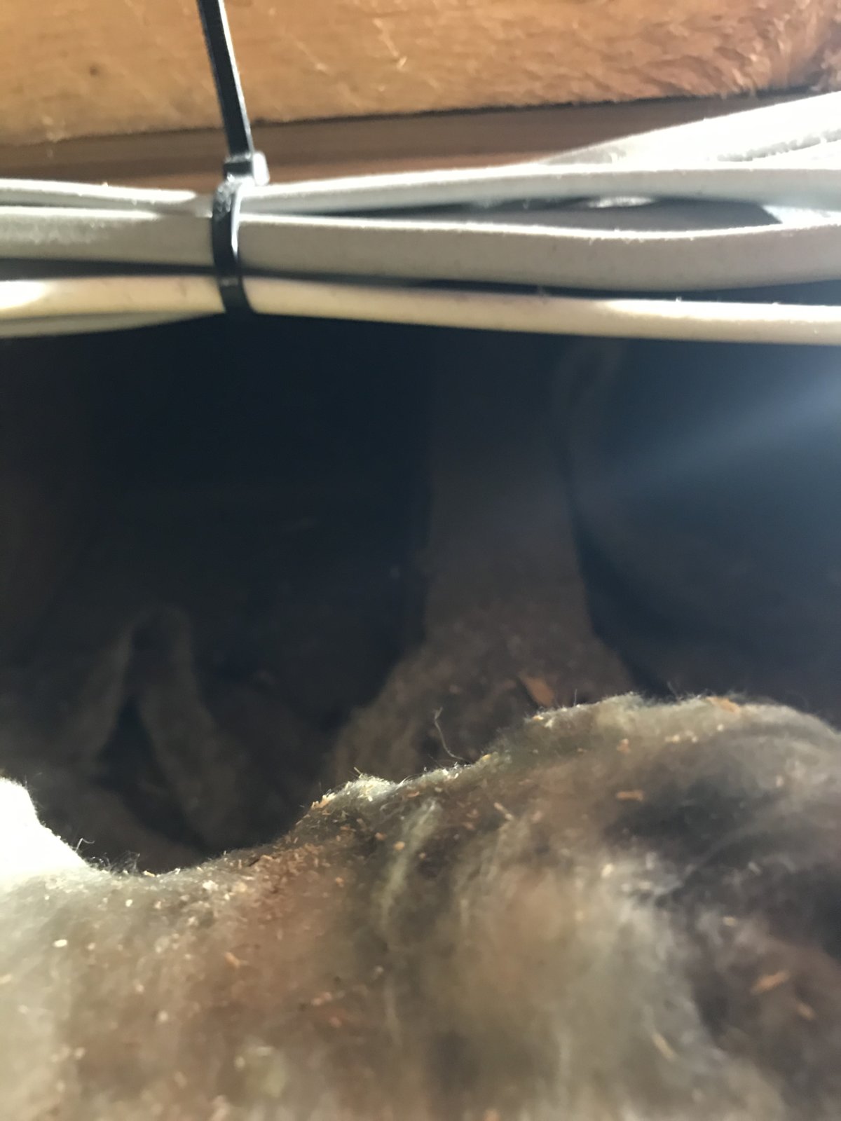

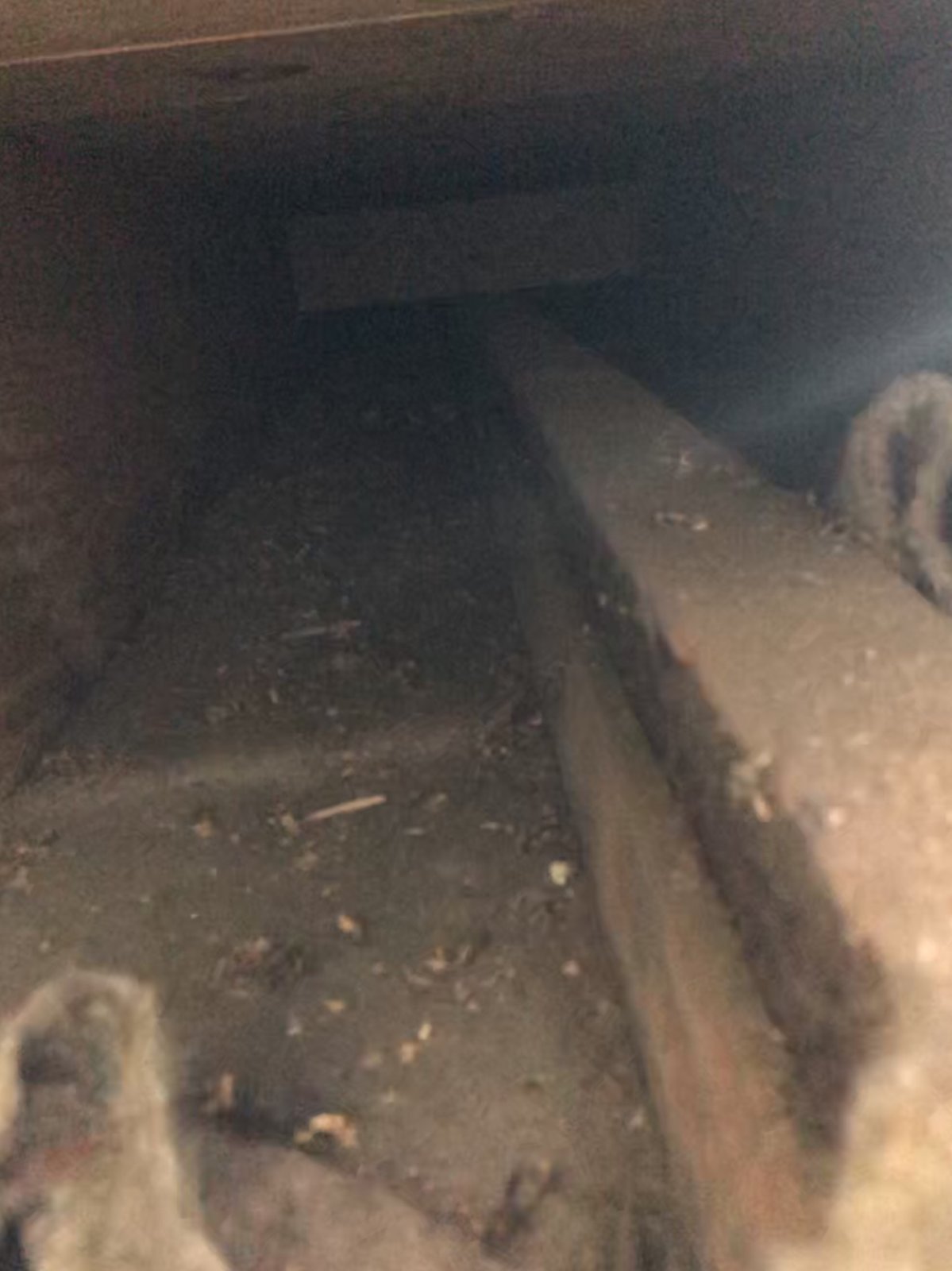

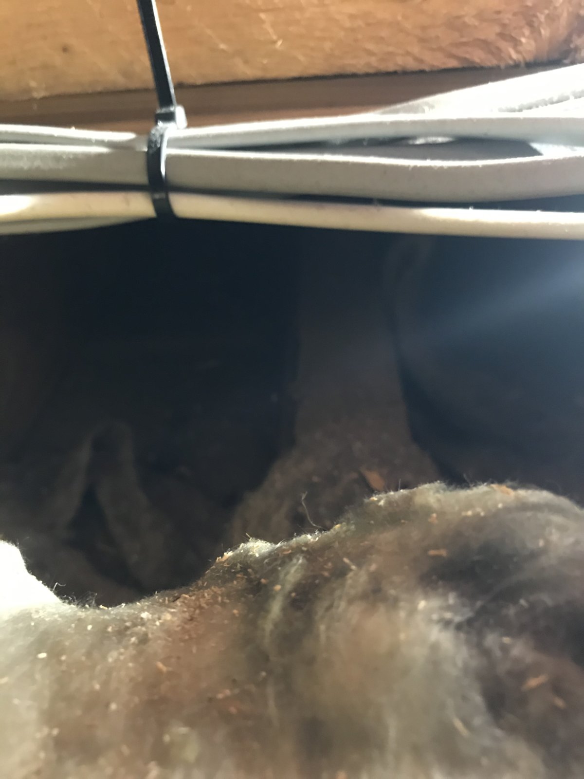

I have noticed on one side of the dormer in the crawl space the end of the joists are exposed (have not checked the other sides as of yet). I assume I am losing vast amounts of heat here as the rooms below have a draughty feeling.
Would Kingspan\Celotex be suitable to fill these area's or can I just push some insulation wool in when I do the rest of the area?
Peeling back some of the insulation on the stud walls the plaster board has a silver backing - I assume this is vapour proof? Should I leave the wool type of insulation here or replace with Kingspan/Celotex?
I would really like to clear it all and start from scratch!
