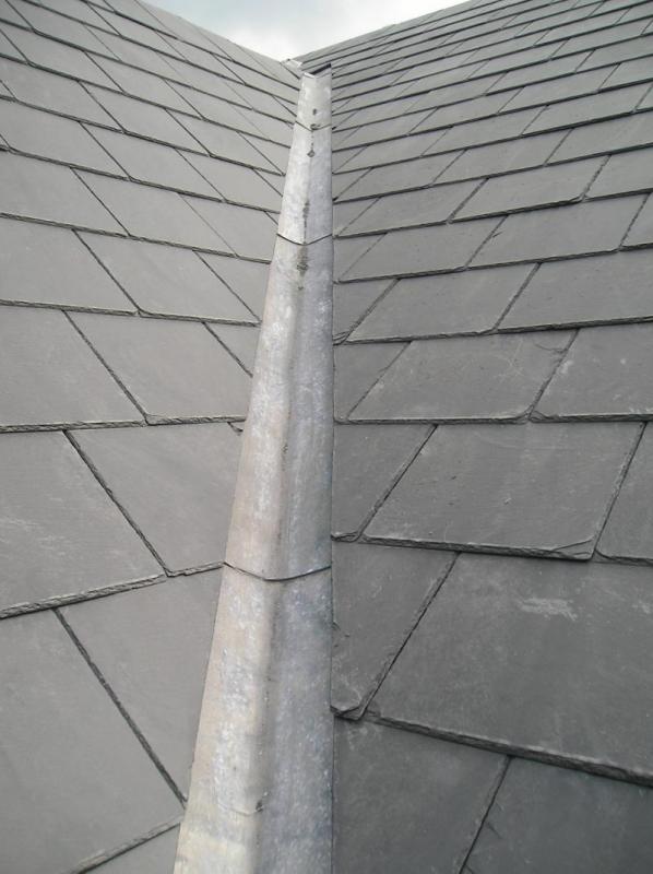

im about to start my new roof next week and need a bit of advice on setting out the slates
im using marley melbourne interlocking slates and need to know if the slates on the main roof should line up with the slates on an intersecting roof which is slightly lower, do i simply do the standard battern gauge calculation for each roof and be done with it or do i try and make the guage on the taller roof match the one of the smaller roof, even if it means the top slate having a larger overlap
i hope this makes sence

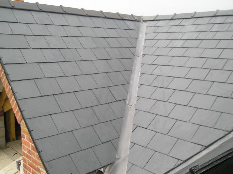

ive included a few pics to try and explain what i mean
in the pic attched, that i found on this forum
the slate on each roof do not line up, is this normal?
cheers
jon
Treat each roof area separately, don't try to line up the courses.
Work out the number of courses required and set the battens so that they are all at the same gauge, that will ensure that the finished roof looks 'right'

They dont line up because they are slates and not interlocking tiles.
The slate would likely have been pre holed for 100mm head lap. So the gauge is set in stone so to speak.
There are different fascia hieghts so rafter lengths are not the same. hence slates dont line up pefectly.. not a bad job though..
You can adjust your interlocking tiles gauge within limits to try and get them to course.
