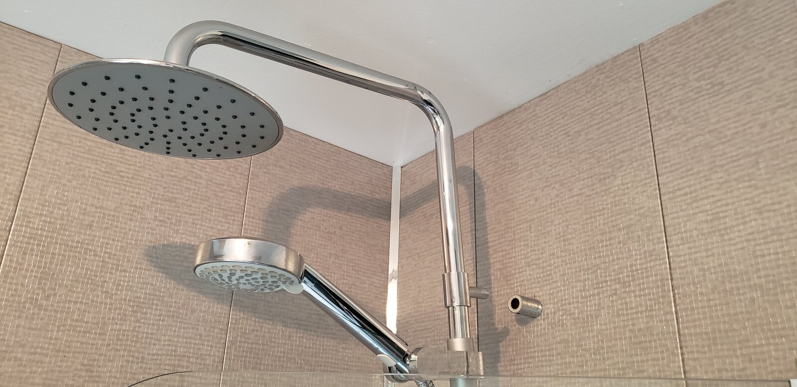

Hi

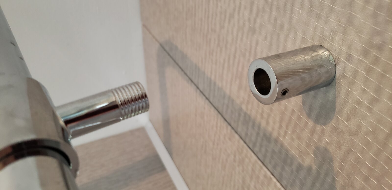

My shower head has decided to do a leaning tower of Pisa. I'm not sure what I need to fix it, maybe a screw of some sort? Help please.
See that little hole in the side of the metal tube attached to the wall? That’s a grub screw. Push the pin attached to the shower riser back into the tube and tighten up the grub screw with an Allen key and you’re all fixed.
