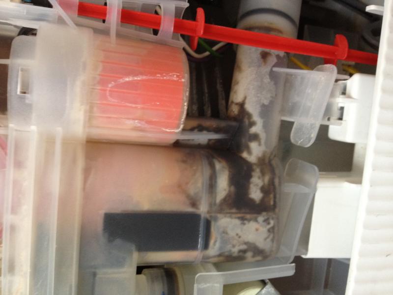

Hi all,
I've a Siemens dishwasher (model SE 25M5275GB/17) that has stopped working.
I put the dishwasher on last thing at night and in the morning the programme still showed 1 minute left....!
The dishes were still dirty and appeared to be dry.
I checked the filter even though I've always kept it clean, reset the programme and put it on a 'Quick Wash' cycle.
The programme 'counted down' to 1 minute and stayed at that until I switched it off. The items were still dirty and hardly wet although the reservoir at the bottom of the machine did have some water in it.
I tried it once more but this time I opened the door during the wash. The spray arm had some water flowing out of the holes (didn't appear to have been spinning very fast though..)
I've taken the left hand side off and am confronted with plastic tanks half full of water attached to hoses and now I'm stumped and don't what to do. :?
There appears to be a lot of black gunk near the orange thing and wonder if I should try to clear it and if so, how do I do it ?
I'd really appreciate some advise.
Take the grey hose, this end as in picture, off and push a bottle brush as far as it will go to remove fat and food deposits in the hose. When you have got it working I would recommend a simple cheap descaler every 6 months to remove greasy deposits.
Good luck
Colin
