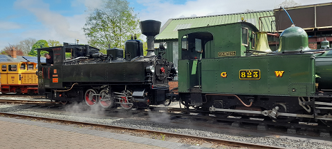

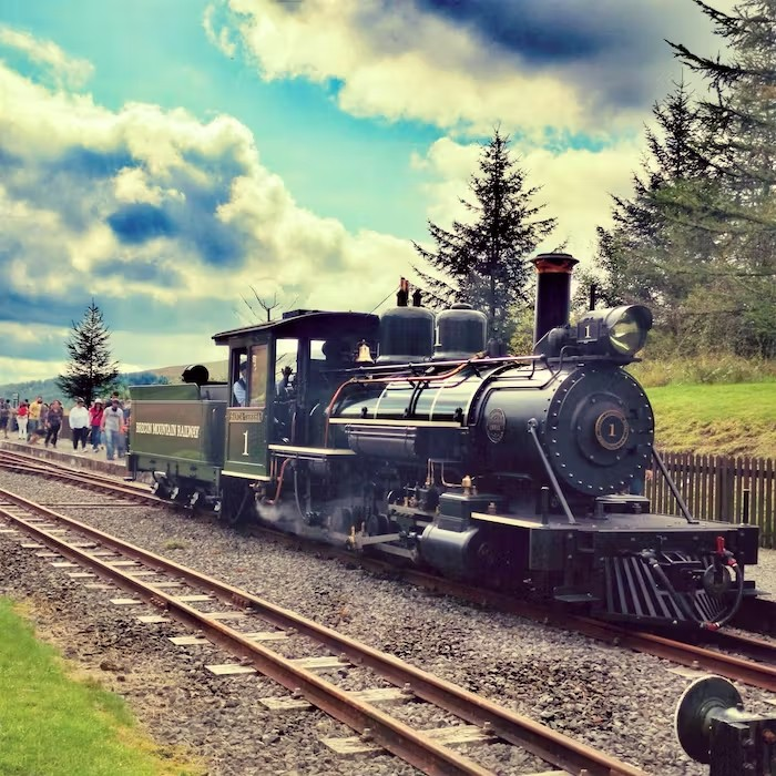

Looking at running railways, the yellow one at back came from a sugar plantation, the centre one from Zillertalbahn and green one belongs to the railway. The railway as original ran through the streets (not any more) the result is bells and whistles and head lights. But to run with only two steam engines is not really going to work the countess and the earl are old engines, the 8 mile of track has 3 passing places so in theroy could have four trains running, and on a gala with goods trains it may have them, but normally only two. However the 2'6" gauge means models are hard to do with 16 gauge there is no standard track, well not much in the UK still running yet at one time it was standard for the military.
But unless non standard gauge, the engines have no bells as they travelled in fenced off track, no head lights as the can't shine far enough ahead and would blind the driver from seeing things a mile ahead, so we have to use British standard gauge engines to look right.
