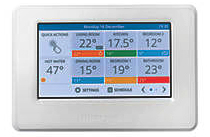

The old Evo home EVO-home1.jpgallowed you to control it from a central unit, most you need to use a phone, the old Energenie TRV head I could control from a PC, but could not control it direct on the TRV. Wiser should work with an emulator on the PC, but it is so slow, tablet or phone is the only real method.
