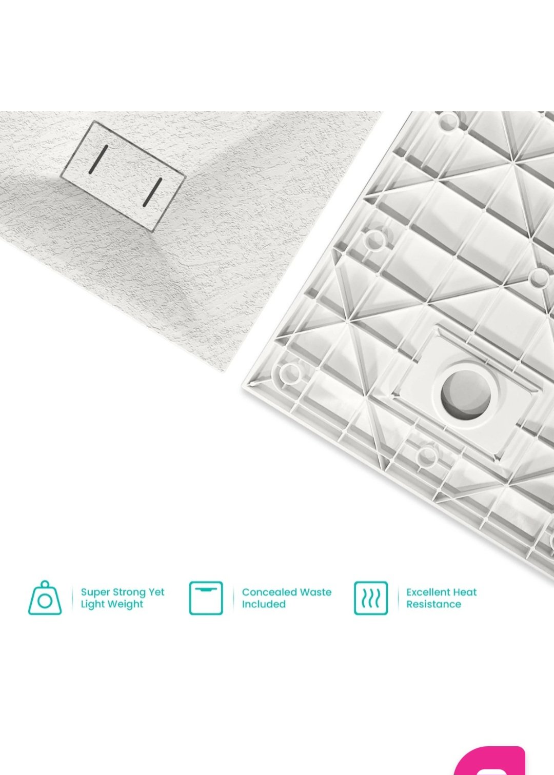

Hi,
I need some advice laying my shower tray. Its a light weight low profile SMC shower tray. Some what flexible too. Subfloor is 18mm chipboard that im going to put 6mm tile backing board on for the tray. There isn't much in the instructions and just say silicon the floor.
The floor is not perfectly level, maybe out by 1 or 2mm in some places. Would using a lot of CT1 for example and using weights level and set the tray or should I use something like a tile adhesive instead to make sure its level? The back is not flat like a stone shower tray as can be seen in the photo. Thanks.

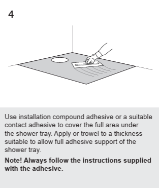

https://www.plumbworld.co.uk/documents/lightweight-shower-tray-installation-guide.pdf "Note! Silicone sealants, foams, mastics, installation compound adhesive or similar MUST NOT be used as a substitute for cement."

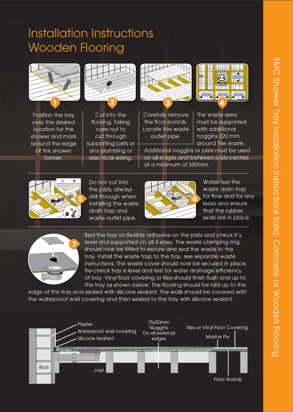

It all seems to depend on the manufacturer that is detailing the installation method as to what they ask for. That is 4 different methods that they ask for when it comes to MSC trays
and then in the plumbworld link they do say to use Installation compound adhesive, even using a contact adhesive -
seems there is absolutely no standard when it comes to setting trays down these days. Quite honestly, these days I will always go with what makes sense rather than what they ask for, hasn't failed me yet.
But still ask for full coverage, not sure how that'll happen. Each to their own I suppose.
