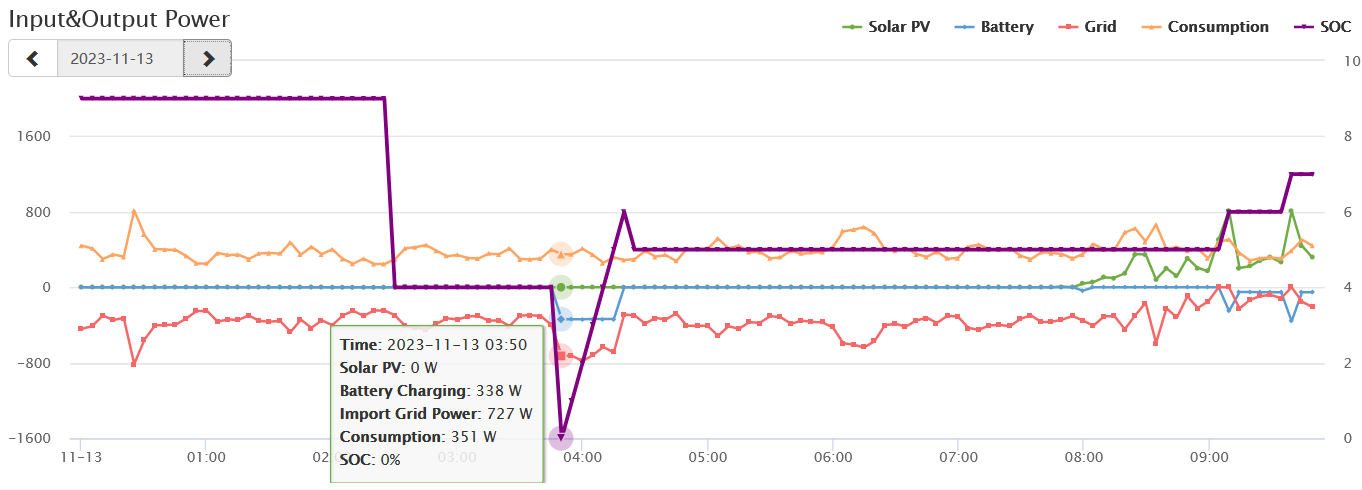

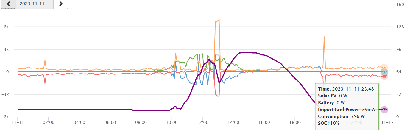

Theory the battery should not discharge any more once it hits 10% where there is grid power and 3% when grid power is lost, this means I will always have some power to run the central heating if grid power is lost, and should prevent battery damage due to over discharge. This is what I expect to see, the purple line state of charge being flat as it drops to 10%

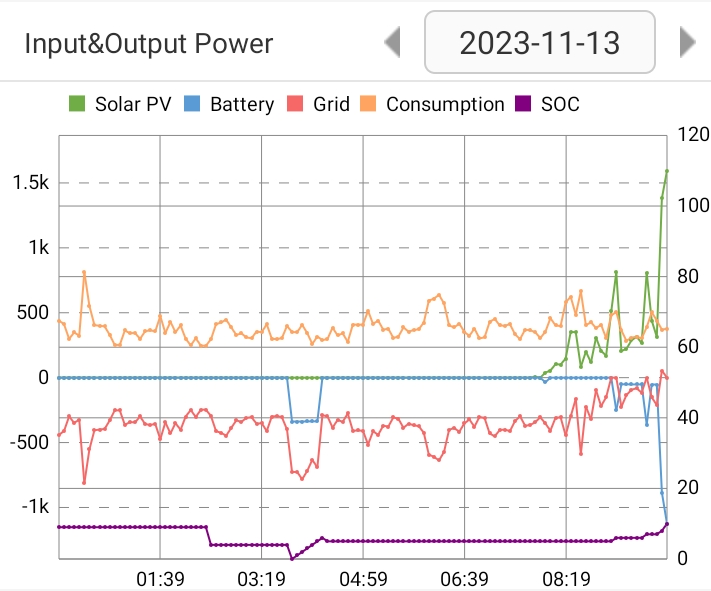

However most days I see this, where the state of charge drops to zero for a short time.
And often does not return to 10% for quite some time, so the back up which should be there is gone. And already had one battery fail. This was replaced FOC and the firm which installed the system do seem to be trying to resolve the problem. However is this problem just with my system, or is it wide spread, the chart is from the PC, the phone app does show it, 1699869745784.pngbut harder to find and see what is going on, so may be people are simply not aware it is going on? One can't hover a mouse pointer over the chart on a phone to show the window seen on PC version giving the data.
Also it should not be charging a battery when also importing from the grid, as the day goes on and the usage increases, and the solar increases the scale will change to accommodate the higher figures, so again harder to see what has happened.
But is this normal and most don't notice what is going on, or have I got a rouge system?
What do you want it to do? There can't always be enough sun to charge the battery, so at some point you are going to be charging it from the grid [or to put it another way, shifting some of your grid import from peak to off-peak].
From that first graph I guess the battery was charged whilst the sun was shining to avoid exporting to the grid. Then you had a shower at 1300 and some grid import was avoided by draining the battery. The battery carried on charging after that, to about 95%, then when the PV output dropped off, the battery was drawn down. It all seems fairly sensible to me.
Not sure what's going on in the second graph with the SOC. Going from 9% to 0% instantly when the battery metric [which I assume is power in/out of the battery] is at 0 makes no sense. Is it "balancing the cells" or something? [Bit of EV terminology there, maybe completely irrelevant].

Have you any idea how the 'state of charge' (SOC) is determined, estimated or measured, and how accurate/reliable the figures are? Your second graph seems to indicate that the figures are fairly 'course', only being able to change by increments of 1%.
However most days I see this, where the state of charge drops to zero for a short time. .............. And often does not return to 10% for quite some time, so the back up which should be there is gone. And already had one battery fail.
I am very suspicious from those apparent very sudden drops in SOC, from 9% to 4% at about 02:30 and then from 4% to 0% a bit before 04:00. There were no changes in demand at those times and, throughout that period, grid supply exactly mirrored consumption, as one would expect. I therefore strongly suspect that those apparent changes were 'not real' - unless there is something fundamentally wrong with the (replaced) batter which causes it to suffer from very sudden spontaneous falls in SOC.
However, 'the system' presumably did take those apparent changes seriously (as 'true') since, when SOC apparently fell to zero, it seems that it immediately started charging the battery from the grid, and continued charging it (for 20 minutes or so) until SOC rose to 6%, after which SOC remained at 5% until a little after solar power started charging it at around t about 09:00,when, as expected, SOC started to rise (albeit still only 7% at about 10:00.
Is that 'emergency charging' of the battery from the grid (when SOC falls to zero, or near-zero) something you know is meant to happen?

Fair enough - but, as I said, I strongly suspect that those apparent sudden and very rapid appreciable drops in 'state of charge' are not 'real' - i.e. they are probably due to some fault/error in whatever it is that is assessing/.measuring that 'state of charge'.
Even ancient, dying batteries do not usually behave like that.
If I were in your position, I think I would probably try to find a way to continuously monitor/record the voltage across the battery terminals, and then compare that with the 'state of charge' graphs you are seeing.
