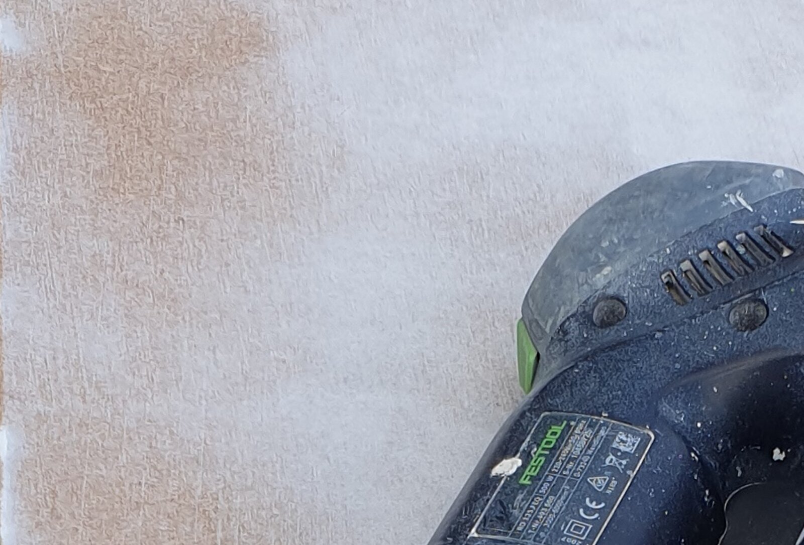

What are they planning to spray it with?
The hardest finish I have worked with is 2K. It is not suitable for spraying in occupied properties because of the isocyanates in the paint. There are one part cellulose paints that can be used in homes (they too stink though). Both are far more durable than any water or oil based paint.
Prior to painting, MDF needs a thorough sanding with (approx) 220 grit paper. The factory finish has very slight grooves left over by the drum sanders that they use.
The above is MDF with a coat of primer which has been sanded flat. You can see the grooves.
The amount you pay will be dependant on the quality of finish that you want. In theory, the sprayed finish will be the highest quality of finish, but there will be a lot of time spent masking and sheeting up.
Depending on the paint used, it might be the more durable option, and may cure the fastest. Given the rapid curing time, it might be the case that it could be completed in one day. You will may however be paying for someone to sit around for a couple of hours between coats.
