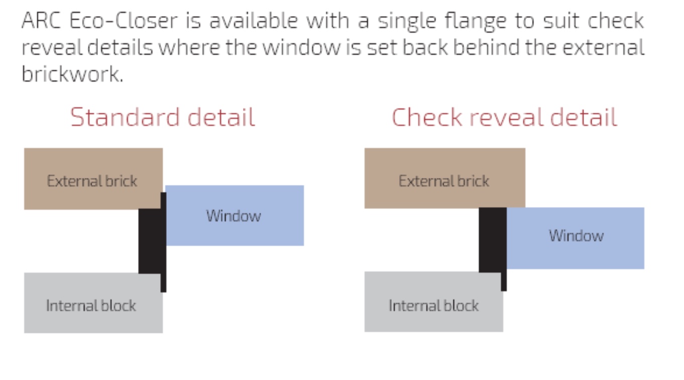

Is it possible to fit UPVC window frames with UPVC exterior sills (No concrete prestressed sill) to a partial fill cavity wall with check reveals?
If so, What supports the frame with it sitting above the cavity void? I can understand with a stone sill, that it can be sat back over the cavity and the window bears down onto it.
My guess would be to stick in a cavity closer, then some steel straps across the inner and outer skin.

Having further looked, I don't think the check reveal will work out well for the sizes that UPVC sills are available in. The available sill sizes are, 125/150/180/225. 60mm of that sits under the frame & a 40mm over hang is required leaving too little or too much.

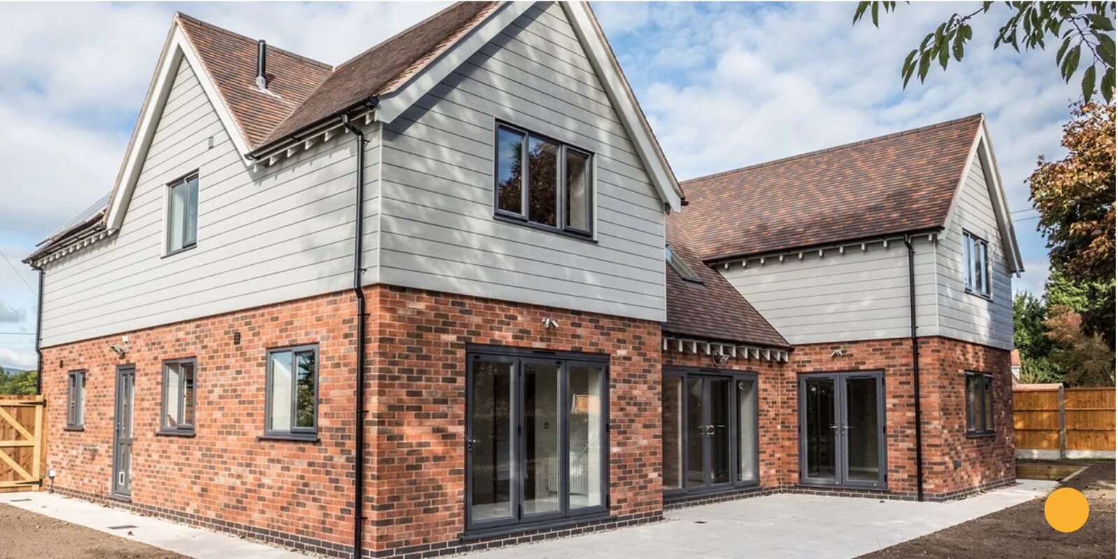

Because I'm considering using a fibre cement wall cladding on parts of the upper elevation, this attached to battens adds an extra 50mm, I'd have to have standard reveals with 225mm & 180mm sills for the cladded and none cladded areas. This would mean the window was set back by 75/80mm from the front wall. The cladding company recommends not using any stone window sills for some reason. A photo on their website doesn't look like theirs much of an overhang.
