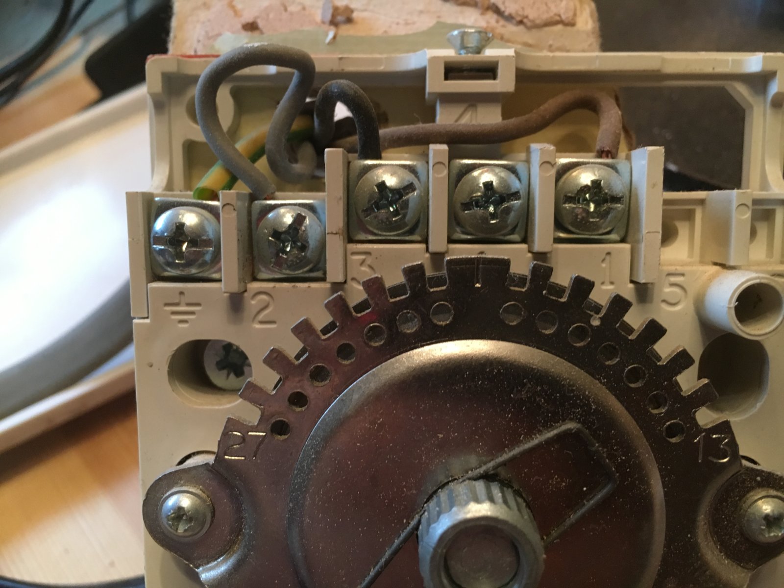

Hi everyone

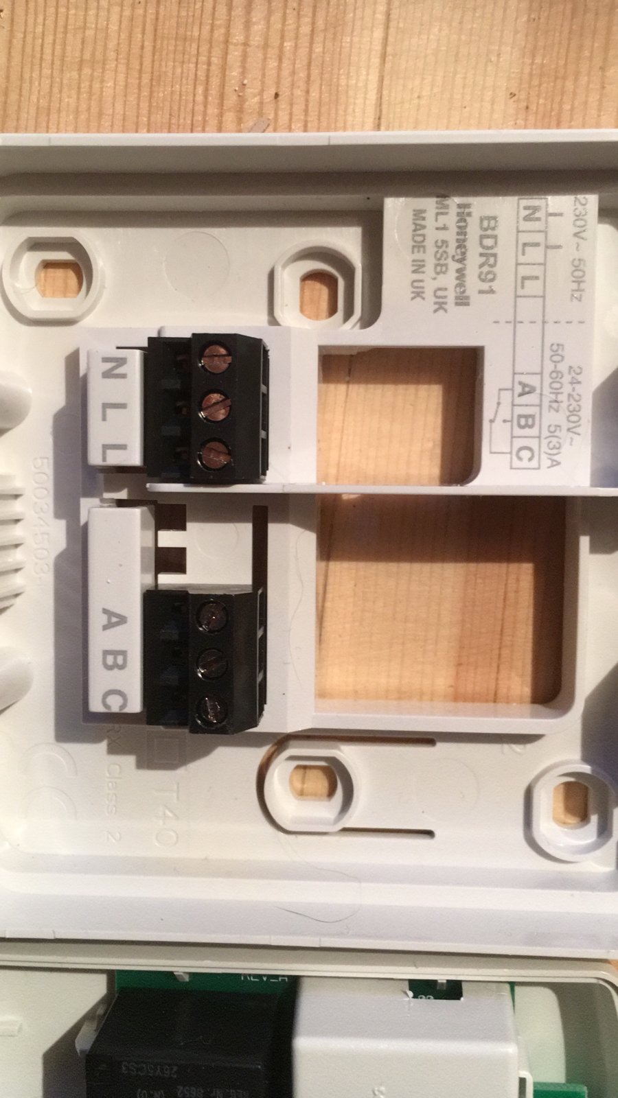

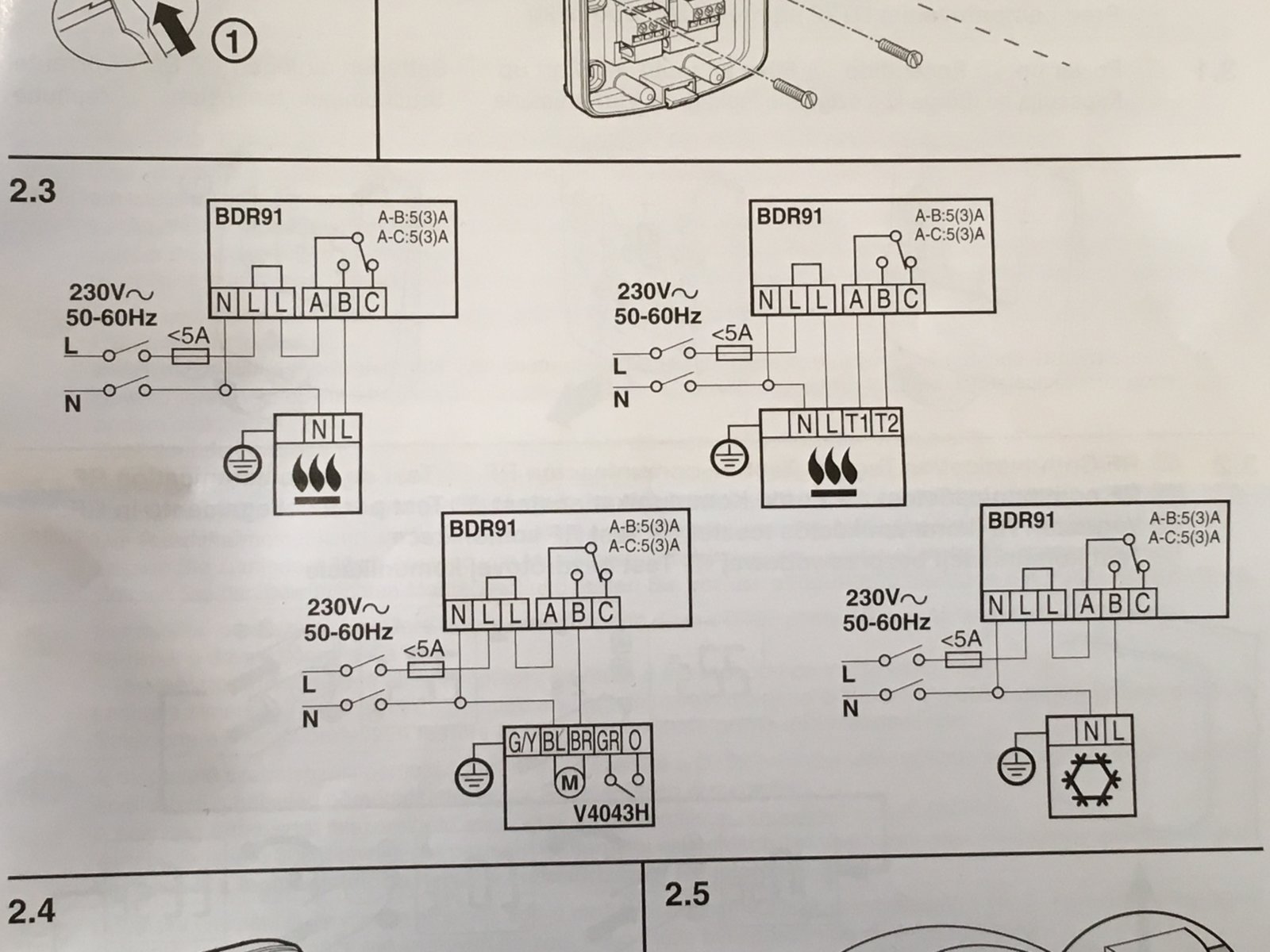

Hoping you can help me here. Want to swap my old thermostat with a new remote one, however, the instructions tell me very little. Can anyone tell me what wires go where in the new BDR91 please?
In the old thermostat, I can confirm wires 1 & 3 are live and 2 is neutral. Also, where does the Earth go?
Thanks in advance

1 is Live
2 is Neutral
3 is Switched Live
So,
1 to 1st L
2 to N
3 to B
and you will need a link wire from 1st L to 2nd L
and a link wire from 2nd L to A.
Nothing in C.
Put the earth wire in a separate connector block and position safely out of the way.
Thank you so much. Done what you said and all working now.
