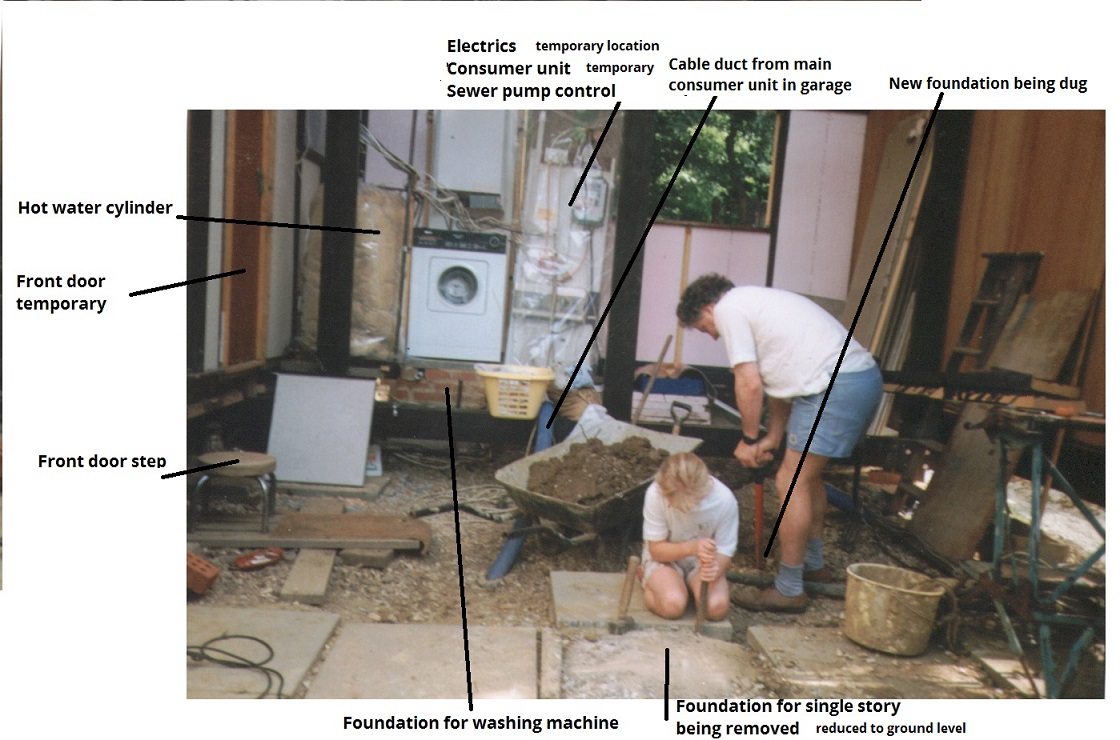

When we did our house /kitchen, the damn sink was moved on an almost daily basis :lol:.
As did the oven.
The hob was a camping thing. Did us for 6 hellish months, but SWMBO still managed to get fantastic grub dished up nearly every day. Friday was curry day for the builders.... Never got so much work done as we did on a Friday morning.
A good friend has never been involved with a renovation, but when we showed her the photo's of our house beginning to end the look of horror on her face was, well, intense. :lol:.
Bless. It is a cultural thing.
Replacing a single storey porch and small utility room with a larger footprint two storey extension.
