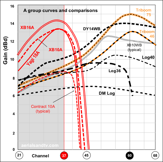

My current aerial was put in by pointing in the direction of Kilvey Hill ..... and I adjusted for best reception. just wanted to align better if I buy a new aerial.
Where I live is not a strong signal area - SA10 6HR Unfortunately there is part of village (confirmed in maps above) which is marked as poor coverage, right where my house is.
Same reason I have very poor mobile signal, walk 50m to end of the road it's OK.
the chances of a very slightly better adjustment may not gain much

My current aerial (fitted in loft) is an XB5 and been advised that an XB10A is right aerial for Kilvey Hill and will give me much improved reception.
