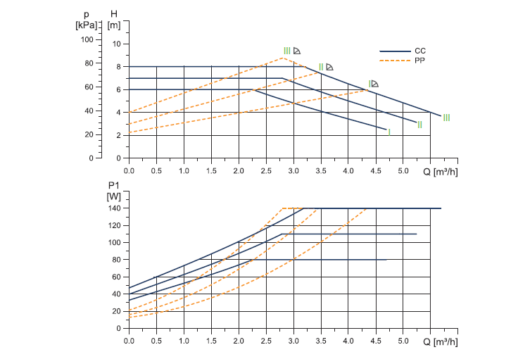

OK so to clarify. This is a system designed by Uponor. It has run correctly for nearly 16 years and following a course with Uponor it is a DIY installation. When it first started failing to circulate correctly I initially purged the system believing that to be the problem. No success so called out a local engineer. He discovered that the mixing valve was siezed ( it is a Esbe Motor Valve ( 3 way mixer with actuator) supplied by Uponor. Freed it off and following a quick test believed it was working OK. Following further running it was obviously not the case. Believing the engineer for various reasons (mostly intuition) was not really conversant with UFH I employed another recommended by a previous Uponor engineer who no longer dealt with Uponor. But before doing so changed both boiler pump and UFH pump. Engineer spent a considerable time checking the system including purging all loops. Having at least got heat to the upstairs manifold and with time pressing he said "seems OK now " left. NOT the case no obvious flow through the flow meters. New pump is a UPS2 25-80.180 which is an exact replacement model previously fitted. It`s installed in the flow pipework and with the arrow indication flow towards the mainfolds. IT IS NOT A NEW BOILER. Hope all this answers the questions.

Can you post a photo of this manifold with the pump running showing its LEDs, can then see what mode&setting its on, do they compare with the other correctly operating manifold's pump LEDs?, unfortunately, the UPS2 doesn't display the pump power which is quite useful as the flowrate can be derived from it, I've often attached a plug in energy monitor to these type of pumps including the UPS3 to get this info.
