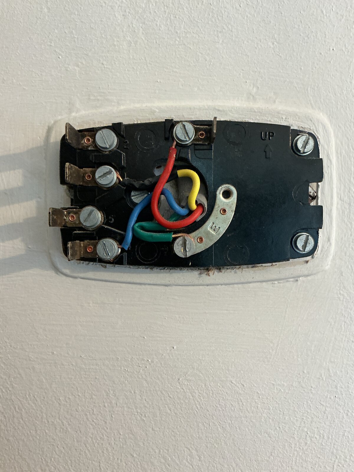

I am trying to update a Satchwell TL thermostat to a new Honeywell T6360 thermostat. When I wire up the new stat the boiler is not firing.
The wiring of the Satchwell is
Red = Live
Yellow = Neutral
Blue = Switch
Green = Earth

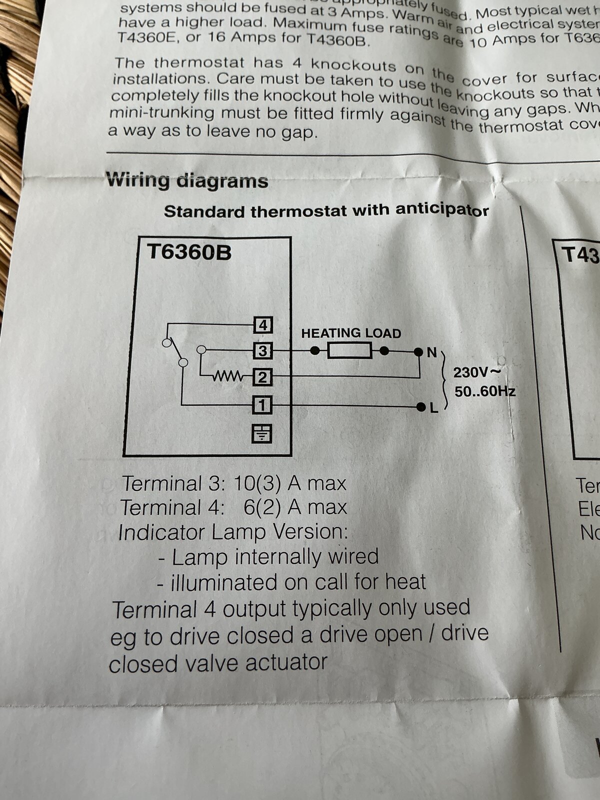

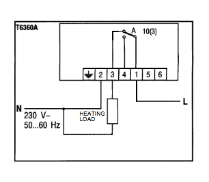

The wiring diagram for the Honeywell is in the pictures and I have tried:
Red to 1
Yellow to 2
Blue to 3
Green to Earth
And
Red to 1
Blue to 2
Yellow to 3
Green to Earth
Does any one have any suggestions?
Thanks!
Red to 1
Yellow to 2
Blue to 3
Green to Earth
Red = Live
Yellow = Neutral
Blue = Switch
Green = Earth
If that is correct.
But some thermostats do not have the contacts in numerical order.
Does the existing thermostat work? What type of boiler/system do you have? Have you missed a step like turning the heating on via a timer/programmer?
