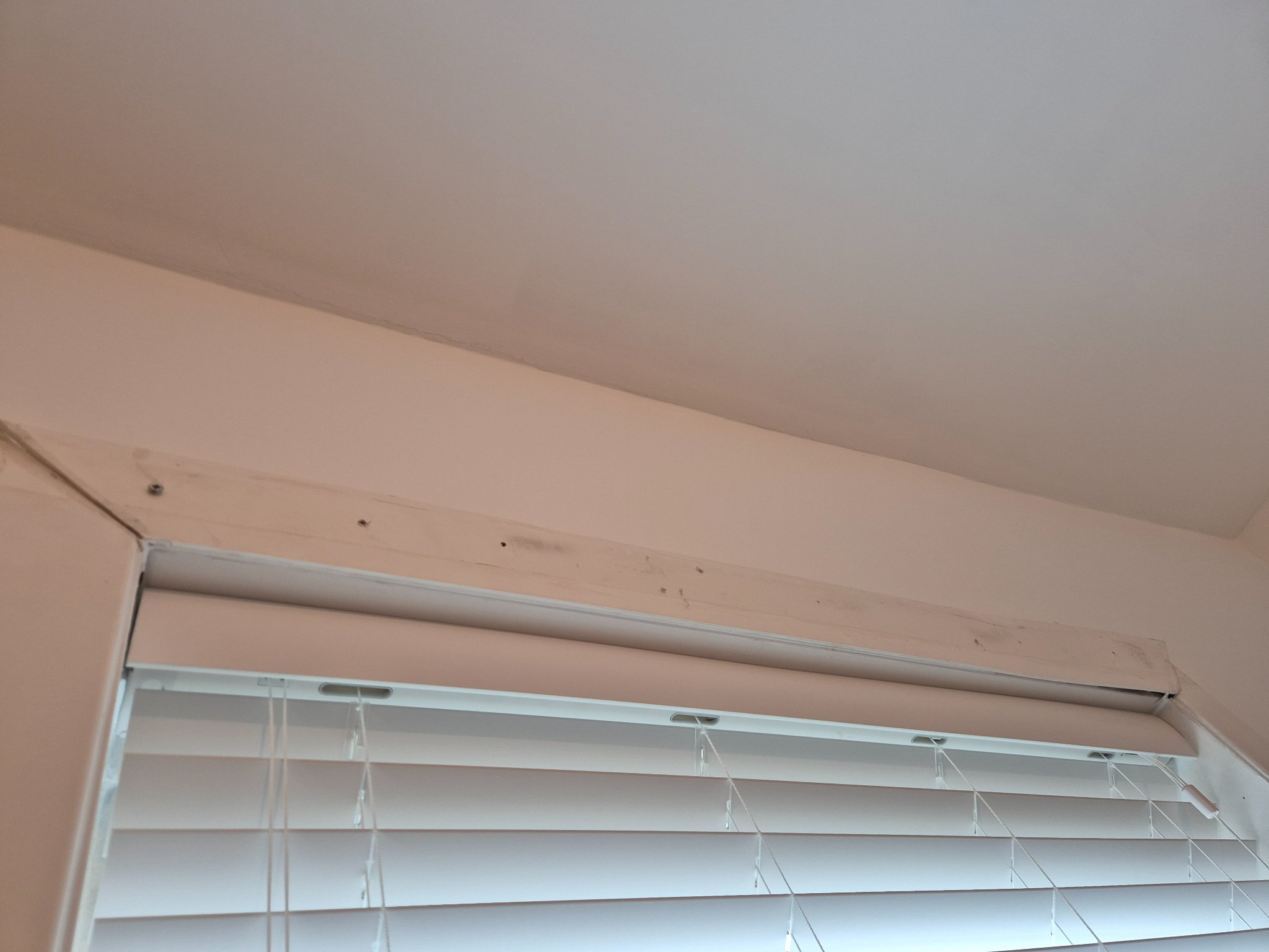

Hi, was wondering if anyone could help. On top of my window the plastic trim has basically all come off apart from the edge. Whats the best way to stick the trim back on? I checked behind and someone previously used tile glue, dabbed it on, clearly that hasn't tacted it in.
I was thinking of using no more nails glue or CT1 silicone?

Use a polymer like CT1 or Stixall but it's not silicone..
Have a can of multi solve for cleanup.
Looks like something was hung on that trim pulling it off.
If you need to use a screw to pull it in use a white screw head cap

A piece of wood was screwed into on the trim, on top of the wood was a light weight curtain pole.
Surely i need to sort out behind the trim with maybe filler first?
What's behind?
It it hollow with voids?
Get that trim off and have a look.
What's behind?
Its basically couple holes with dot and dab of tile glue or something like that. Tried drilling a screw through, doesn't go through
Probably no nails mastic.
Dries hard and brittle.
It's not that good at sticking plastic as it brittle and don't stick well to plastic.
Use a polymer
Yeah. That will do it.
Multi solve with clean it off or use low tac masking tape around wall.
Just don't get in a mess with it although polymer can be painted over
