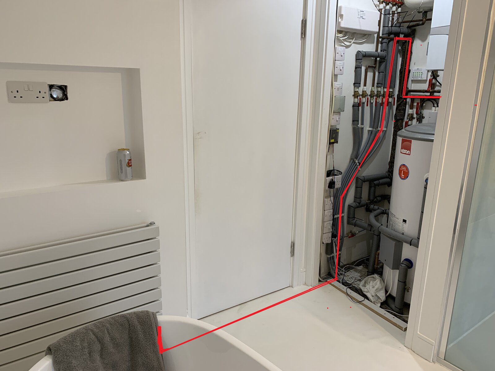

Hi all.
I have the boiler and radiators upstairs, underfloor heating downstairs.
I plan to use Adey MC3 to clean the system and then MC1 to maintain it. After I use the MC3 cleaner, I need to flush the whole system. The problem is I don’t have a drain valve anywhere, apart from the UFH manifold return drain valve.
Is it possible to drain the entire system (excluding the pipes in the floor), using the drain valve on the manifold?
I am concerned the pipe on the left (flow directly from boiler above) is lower then the return drain valve. Will the entire system drain if this pipe is lower then the valve? If not, I am thinking of using the self cutting drain cock to attach to where the yellow circle is.
Finally, once I drain the system, I plan to flush the UFH pipes as if I was re-filling them to clear out any old MC3 chemical. I will then refill the pipes, and bleed any air as per usual.
Also I have radiators which are lower then some of the flow and return pipe work where the boiler is. Will this stop the radiators from draining?
Any advice welcome.
