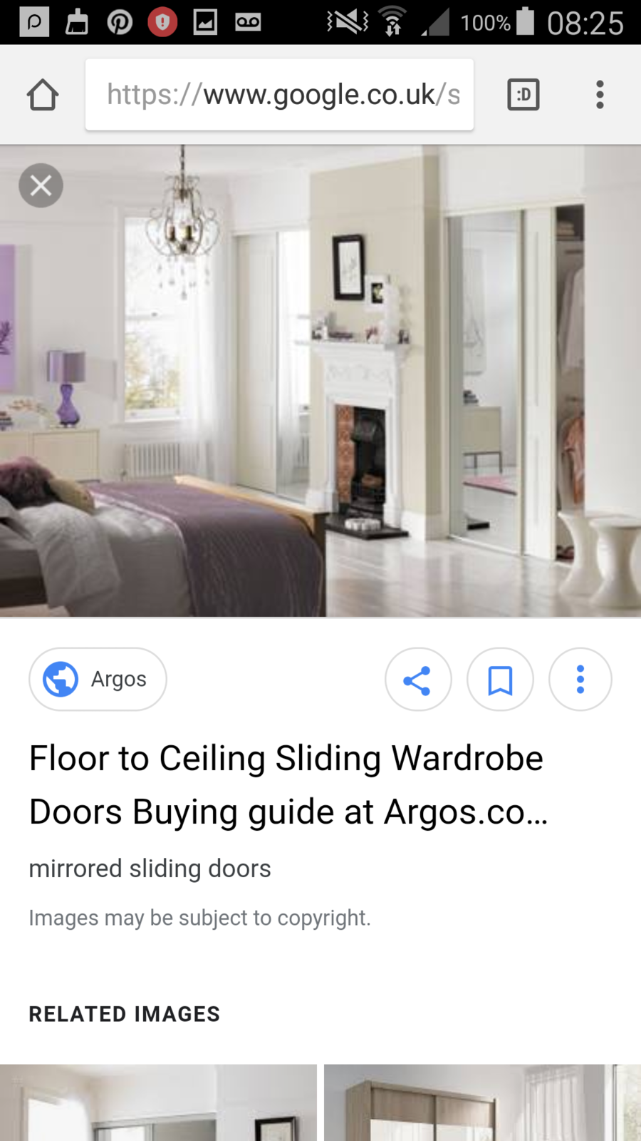

Below is a sample photo (without the fire place) similar to my room. I could stretch the tracks to the wall where the fire place is in the sample photo. This will give me the 138cm width space I need for both doors. Only issue is that am planning on wall mounting a TV there on the wall and the side wardrobe panel will get in the way. One idea is maybe cut side wardrobe panel in 2 to give enough space for the TV to be wall mounted.
Yes, two options. Make the opening bigger or get smaller doors.
I suppose there is a third...
Could you bring the wardrobe track forward in front of the chimney breast and wall mounted TV so that it covers all of that space? You can then have the TV behind the wardrobe doors when not in use or open the doors when watching. Just a thought. Might be worth exploring this as another option
