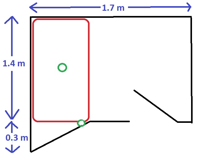

The image below shows a plan view of a bathroom with the location of a bath.
The green circles are the locations of an overhead ceiling shower (centre of bath) and a wall-mounted shower.
The lower left corner is an open alcove from floor to ceiling.
There is obviously potential for water to go into this area, so what possible remedies could be used to prevent this?
Obviously the entire alcove could be blocked off, but I'd rather this wasn't done unless there's no alternative. That is, as the bathroom is 1.4m x 1.7m only.
Perhaps (marine?) plywood could be cut to shape to fit in the alcove from the bath lip to maybe a height of 30cm above the bath. Then some combination of tanking liquid product applied or a cement board applied, or waterproof matting, then tiling. What do you think - thanks!

Potential?? You can almost guarantee that water will find its way in there. Of course you can alway tank that area and then panel/tile it but what do you do about the water that does find its way in there? It will eventually go stale and smell/mould.
You could always put a horizontal panel it at the height of the bath into the alcove and use it as a shelf to hold all the smelly's etc with an IP65 downlighter above it.

What about the option of constructing a timber frame of the alcove plan shape, angle the back of it higher than the bath side (by 0.5 - 1.0 cm), apply a sheet of ply, apply a sheet of cement board (eg AquaPanel), then tile?
You mean if tanked/tiled from floor/bath to ceiling? I'd prefer not to do this in any case as it would make the bathroom feel even smaller.
Good point.
Do you think the wall end of such a "shelf" should be in the region of 0.5 cm - 1.0 cm higher than the front?

It's possible to use that system to run down to a panelled floor in the same system. It looks like a bathroom but has the waterproof properties of a wetroom.
I'd expect it, being purposebuilt, to be less fiddly and more reliable than using a ply and tanking approach.

That size and shape of room would be ideal as a wet room :idea:
Your bath is going to be less that 1.4m in length,it may suit your needs but personally i would at this early planning stage alter all the plumbing and have the bath on the adjacent 1700 wall.
You could have a bath tub made to measure to fit into the alcove,although the bespoke route can be expensive but it would enhance the room and be more suitable.

Much of the 1700 wall is in fact a window (I should have indicated that on the plan).
Also, I want to get a short projection toilet and a slim basin in there as well. With a 1700 bath, unfortunately, there wouldn't be the space.
If I kept the 1400 bath (same location as plan), what has to be done differently to the room to make it a wet room?
I was intending to lay marine ply on the floor. Cement board on the stud walls.
In addition to this, would I apply (for example) Homelux floor matting over the ply floor before tiling, and Homelux wall matting over the cement wall board before tiling?
I believe the overlapping of matting gives even greater protection than the simple butted together cement board.
