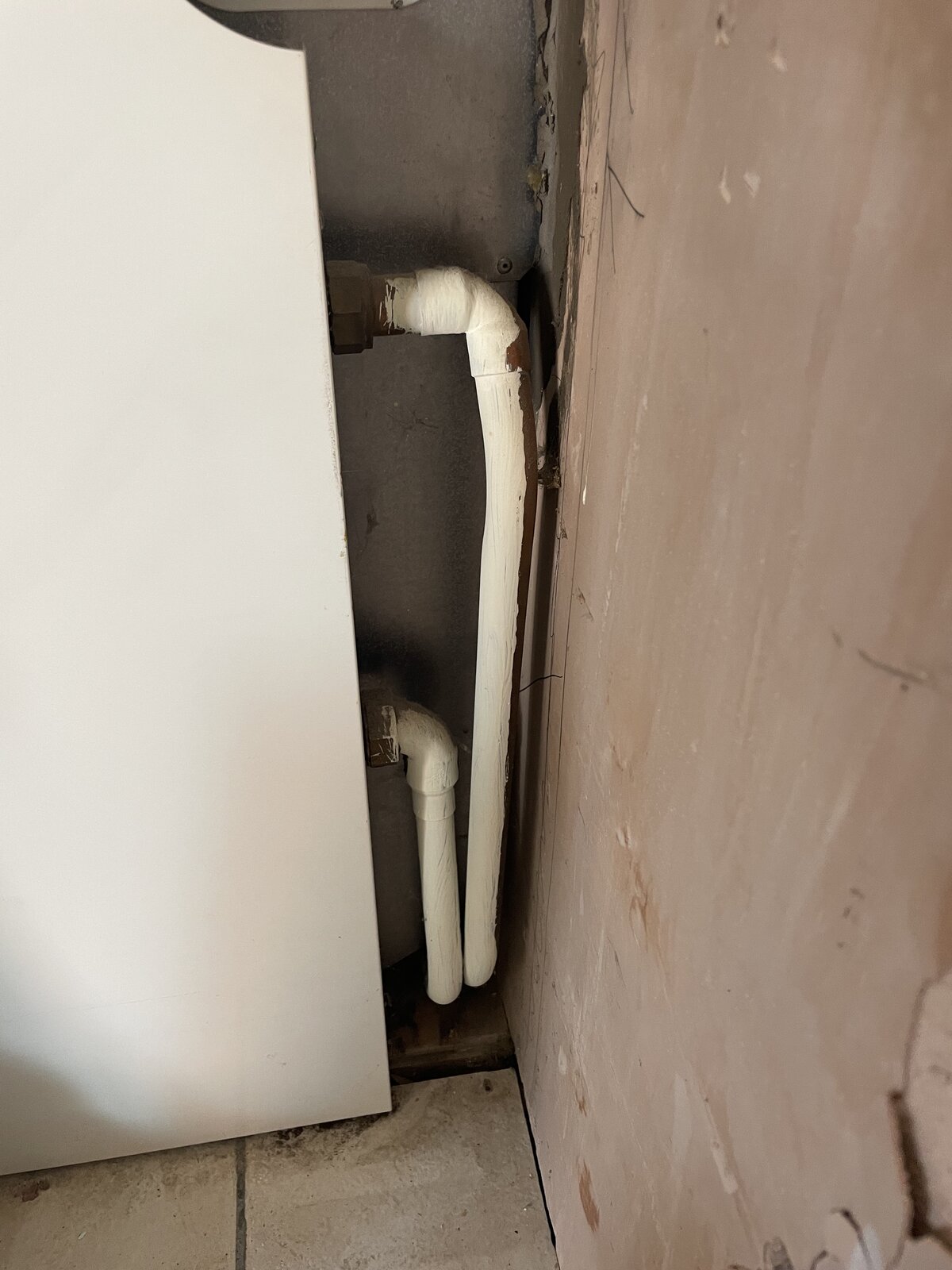

I recently moved and think I might need a new boiler soon and I'd like to know what boiler would be a good like for like.
It has an Ideal Mexico Super 70FF (circa 1999) sounds rough at times, but works!

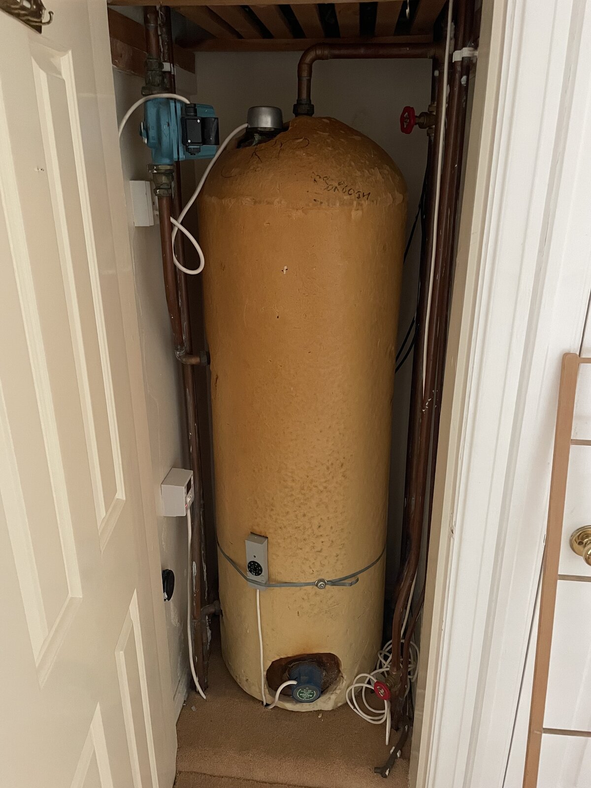

The system has three tanks in loft, one small f&e and two larger water storage tanks that supply bath and shower cold water and to the hot water cylinder.
It has a hot water cylinder with top and bottom immersion heaters, and has a pump next to it to circulate the hot water from boiler through tank.

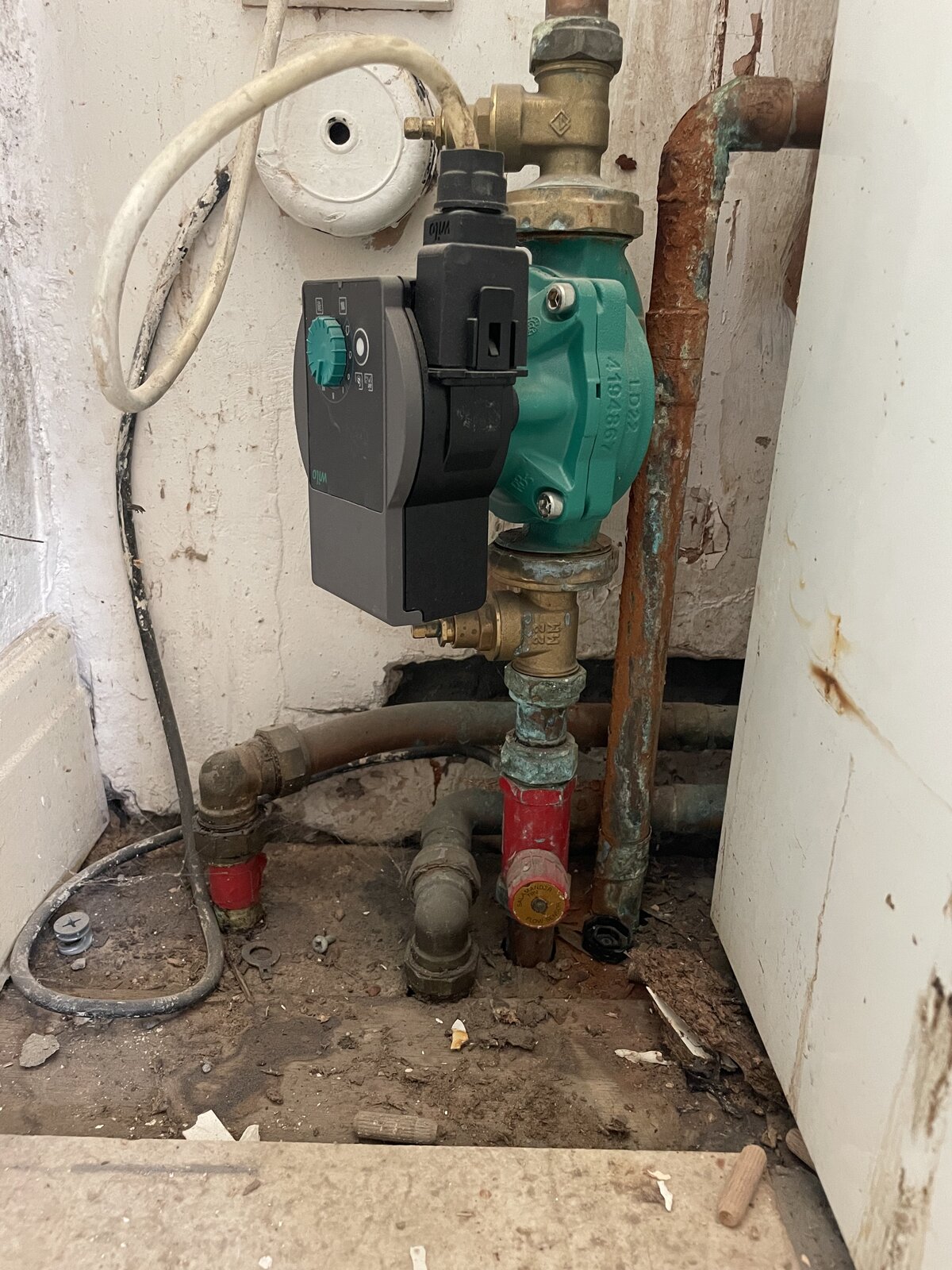

And another pump next to boiler for the central heating (looks new).
It has a British Gas UP1 controls unit and no room thermostat.
The current boiler has 4 pipes out of the cast iron heat exchanger, most new boilers I've quickly looked at just have two (flow and return).
What is this system and what boiler would be best fit to replace, can be wall mounted or floor as enough space.
I really like the system as it is, but would probably like some more modern controls plus room thermostat.

All pipes go down under floor.
Yes two 22mm pipes and two 28mm pipes diagonally on heat exchanger. But all 22mm pipe used and in pairs vertically.
So I assume a pump is being used to move the hot water from the boiler through the coil in the cylinder to get the water around, rather than using 28mm pipe going up from boiler and hot water rising system like in our last house.
So what's this system called?
Most new boilers I see just have one flow and return, not two like now. How would a new boiler fit here to keep things the same?
As mentioned, I really like the whole system. I also like that I can heat water on economy 7 or gas.

It's fully pumped.The pump by the boiler is for heating and the other pump is for hot water.
There will be thermostats controlling the pumps.
Correct
I don't think it has a name, it's somewhat unusual
You could put a tee on the flow pipe, to feed both pumps.

With your system, I'd expect when 1 pump is running, there is reverse flow through the other pump and circuit. Have you noticed this, and is it a problem? I'd expect worse in summer when the HW pump is running and the rads get warm, last thing you need in a heatwave!
I don't see why you couldn't install a roomstat, but depending on the house layout, it might be not be too easy running a wire from the best roomstat location back to the boiler or programmer.
With 2 pumps, it must be wired using double-pole switches, or relays oe something, so that when 1 pump runs (and the boiler fires) the other pump doesn't run.
