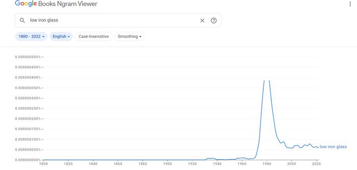

"Low Iron Glass" never existed before 1980 see ngram below.
Something happened then, possibly Pilkington found that it could shove in the face of the ignorant consumers chernobyl glass which it could buy for 10 c on the dollar.

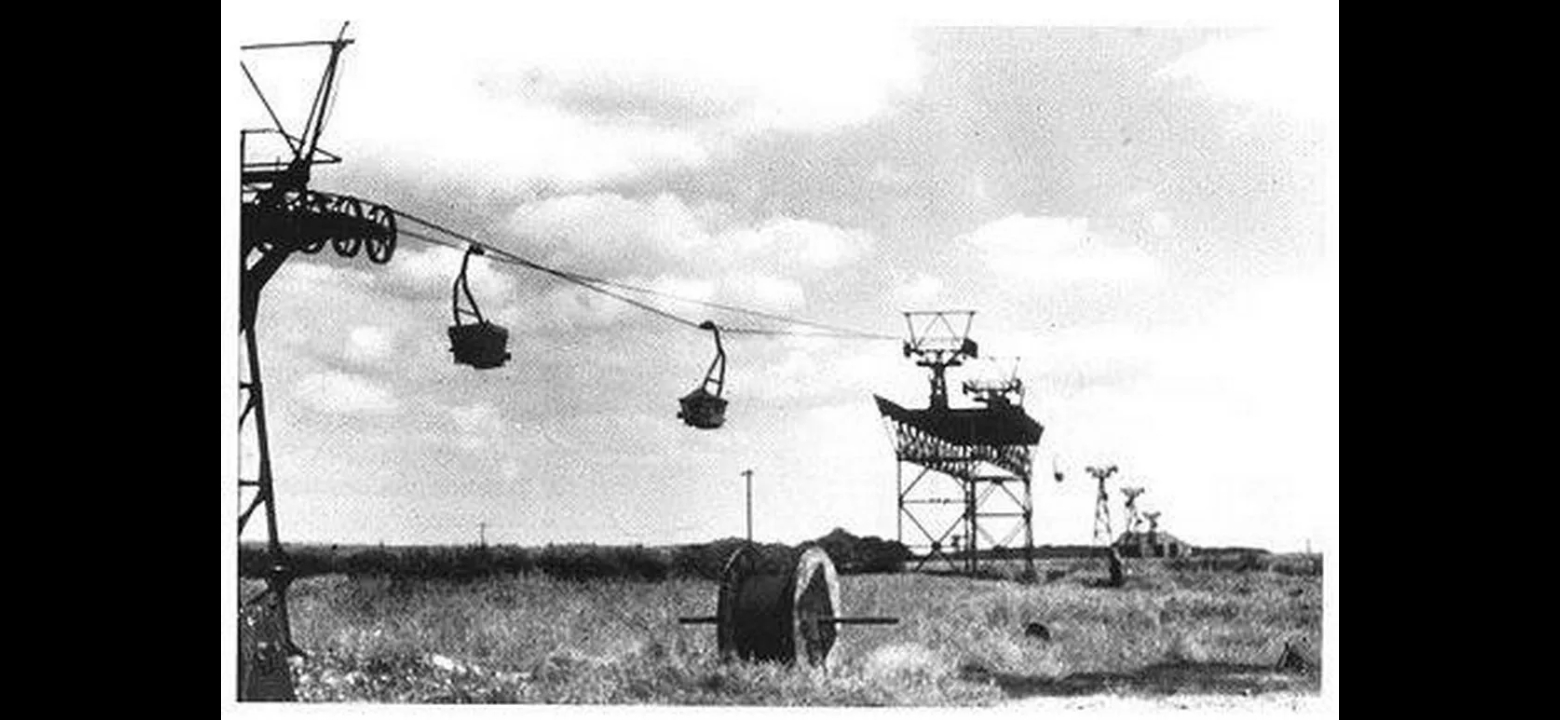

There's one other more local factor you probably aren't taking into consideration - the source of Pilks's sand. Traditionally Pilks used locally sourced sand. In St Helens and across West Lancashire there is a layer of Shirdley Hill Sand sand up to 2.5 metres thick in places, just below the surface soil. That sand, combined with readily available local coal and the proximity to the large conurbation and port of Liverpool made St Helens an excellent location to make glass.
Originally Pilks used this local sand extracted from beneath farmland in West Lancashire by a process known as "sand getting" - where the overburden was removed by an excavator, the sand was then removed and transported to a sand (by narrow gauge industrial or standard gauge rail, overhead ropeway or in later years by lorry), land drains were installed and then the overburden (soil) was replaced. Anyone who drove along the East Lancs Road or Rainford Bypass up until the 1970s would have seen this first hand, although AFAIK the ropeways disappeared in the 60s.
Pilks started to run down the extraction of local sand in the 1970s, but even in 1973 nearly half their sand was locally sourced (140k tons out of a total of 340k tons), the balance at the time coming from Belgium. The better quality local sand was always retained for sheet glass production, but with new methods of sheet glass production (most notably UK5, the first tin-bed float glass plant which came on stream in the late 1970s) it became possible to make a wider range of thicknesses (0.4mm to 25mm as opposed to a maximum of 6mm with the original mercury bed process). From about 1975 local sand was being mixed with Belgian sand for float glass production with Belgian sand being used for sheet (plate) glass produvtion and Fibreglass using sand from Chelford in Cheshire. Local sand getting ceased altogether in the mid-1980s and my understanding is that more imported sand is used these days, especially at the sites outside St Helens
If you are still with me at the end if all that, then the answer us that the type of sand has changed and that the modern glass is made from sandvwith a higher iron oxides content because they now can. It's also worth noting that cullet is often taken in in mixed colours as opposed to separated into clear green and brown as was once the case
