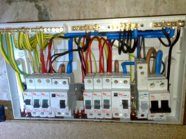

Are the neutrals from the outgoing side of the mainswitch designed to loop in and out of the first RCD, or can they be taken individually from the neutral bar on the MSw side?
milliamp
Board was pre wired wylex unit and the neutrals were as provided.
Main switch out to each RCD in and RCD out to RCD1 and RCD2 neutral rail.

As promised !
One of the RFC circuits was a bit on the short side so I was bit disappointed on the neutrals, but rather that than crimping and extending.
Isn't quite finished, another circuit to go in on athe lhs RCD. and tidying up, but I knew you wanted to see one Chris ! :D
Well spotted RF, to be honest I don't know. They (CEF) didn't have any M2 RCBO's in stock. Why would the use of a non M2 device be against regulations though ?
Depends on the manufacturers instructions I suppose (134.1.1)
Do they only specify the use of their own MCB's?
MI didn't say anything about not using oem MCB's. Can't see a problem with it anyway, if they fit OK. A bus bar and din rail are not exactly in the realms of rocket science !
Yep crap board. , only one MEB terminal, MCB's dont sit well on rail, crap neutral terminals, (small screws) numbered wrong because they've adapted the case off a normal split load board so the sequence is alll over the shop , cheap stickers with only with one rcd sticker, all in all poor for the money. Will stick with hager or wylex in future.
