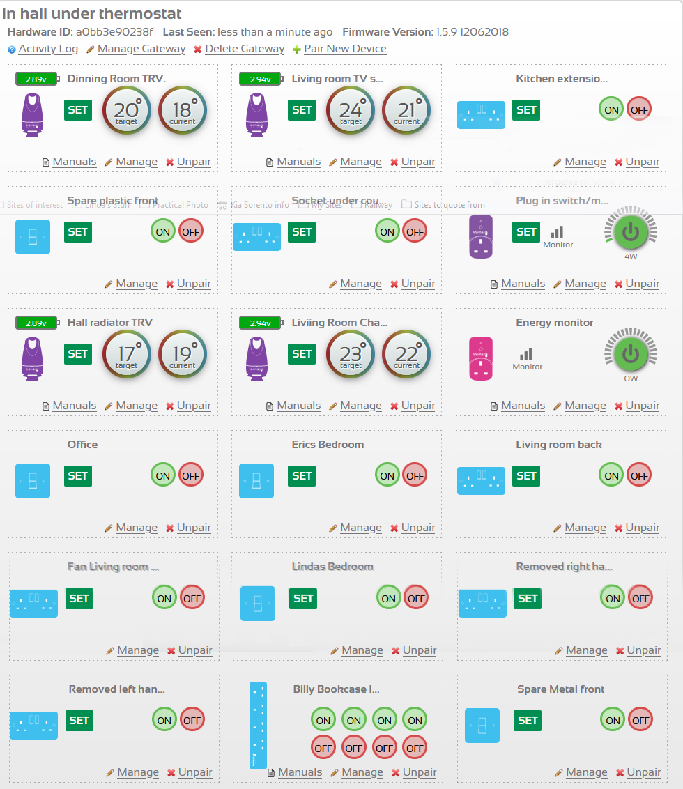

I used Energenie MiHome, not impressed, they can be hard wired, use a remote, or phone, or PC. But Lidi have been doing Zegbee smart switches which do seem to work out cheaper. I got a three lamp unit with GU10 lamps and a remote control. The remote will work with any of their smart bulbs, so it works a wall light and a bedside lamp in my wife's bedroom, and the GU10 lamps it came with just use the phone to control them.
The lidi remote has a plate that can be screwed to wall, and it is magnetic so the switch then sits in the plate like a light switch, but can also be removed to use as a remote. It has worked well for me.
The Energenie MiHome however also worked well when first installed around 4 years ago, HomeBase were selling them off very cheap so I got a load more Mihome-used.jpg and to start with seemed to work well, however Nest removed support so the TRV heads no longer connect to Nest Gen 3 thermostat, and of the 5 light switches only 2 still working, and also a socket has gone faulty, this has taken 4 years, but when the lights decide to flash on/off/on/off you have to turn off power to return to normal switch, and find a normal switch, which was a real pain.
So now using plug in adaptors, at least if it goes wrong easy to unplug. So gone off Smart light switches and sockets built in, now use type I can unplug if it goes wrong.
