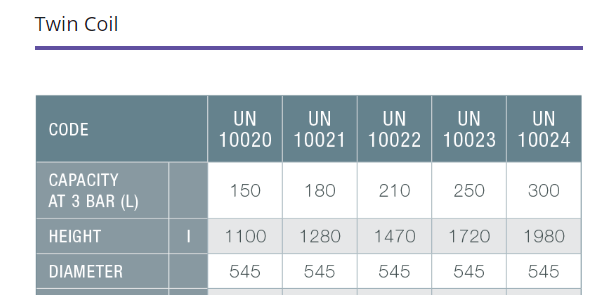

Not sure of capacity, does not say on it.
Can make an estimate. Will be back on site later today.
Not sure of capacity, does not say on it. Can make an estimate. Will be back on site later today.
Fair enough. If you can tell us the rough dimensions, that would be good enough.
I also forgot to ask - are you using this just for providing hot water (from taps etc.), or is it being used for other purposes (i.e. heating).
Kind Regards, John
It is hot water, kitchen bathroom and shower.
Thanks., As for the capacity, this should help you to work out (from the approx dimensions) which one you have ....
I'm a little uncertain of the significance of capacity being quoted "at 3 bar" since the volume/capacity of the cylinder should not change significantly with changing pressure!
Kind Regards, John
Height 94cm diameter 55 cm, external
Cylinder dimensions there are attachments that make it a bit taller.
Height 94cm diameter 55 cm, external ... Cylinder dimensions there are attachments that make it a bit taller.
Fair enough. I therefore imagine that it is probably the smallest of their Twin Coil ones, then (height in table = 110cm), hence 150 litres.

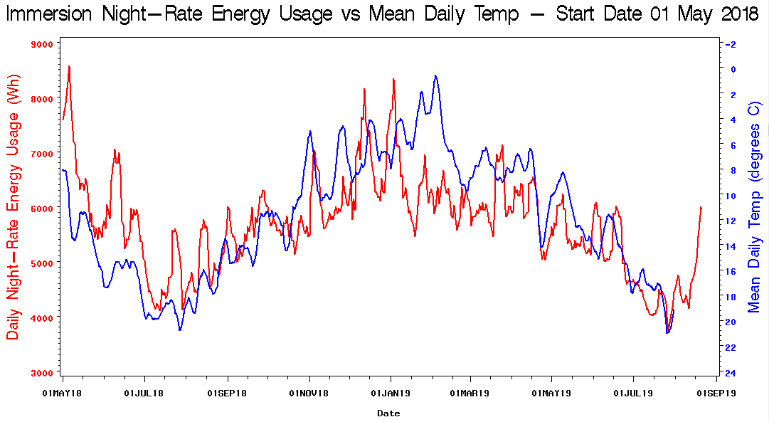

To put this is context, my main HW cylinder is 140L, hence very similar to yours. It does have two immersions, but the second (upper) one is virtually never used. With our usage, the total energy used by the immersion is around 4 kWh/day in mid-summer and around 6 kWh/day in mid-winter (when the cold water is colder and heat losses greater) - corresponding to an 'average power' (over 24 hours) of about 170 W (0.17 kW) in summer and 250W (0.25 kW). The total duration of 'immersion on-time' (controlled by thermostat), for my one immersion, varies from about 45 to about 90 minutes per day.
This graph of my HW heating which I often post here might give you some idea, but for any particular household, one's usage of hot water is obviously the main determining factor. (the very recent high peak in my HW usage is explained by my two daughters having been staying here - hence multiple ludicrously protracted showers and undoubtedly some baths as well!)....
