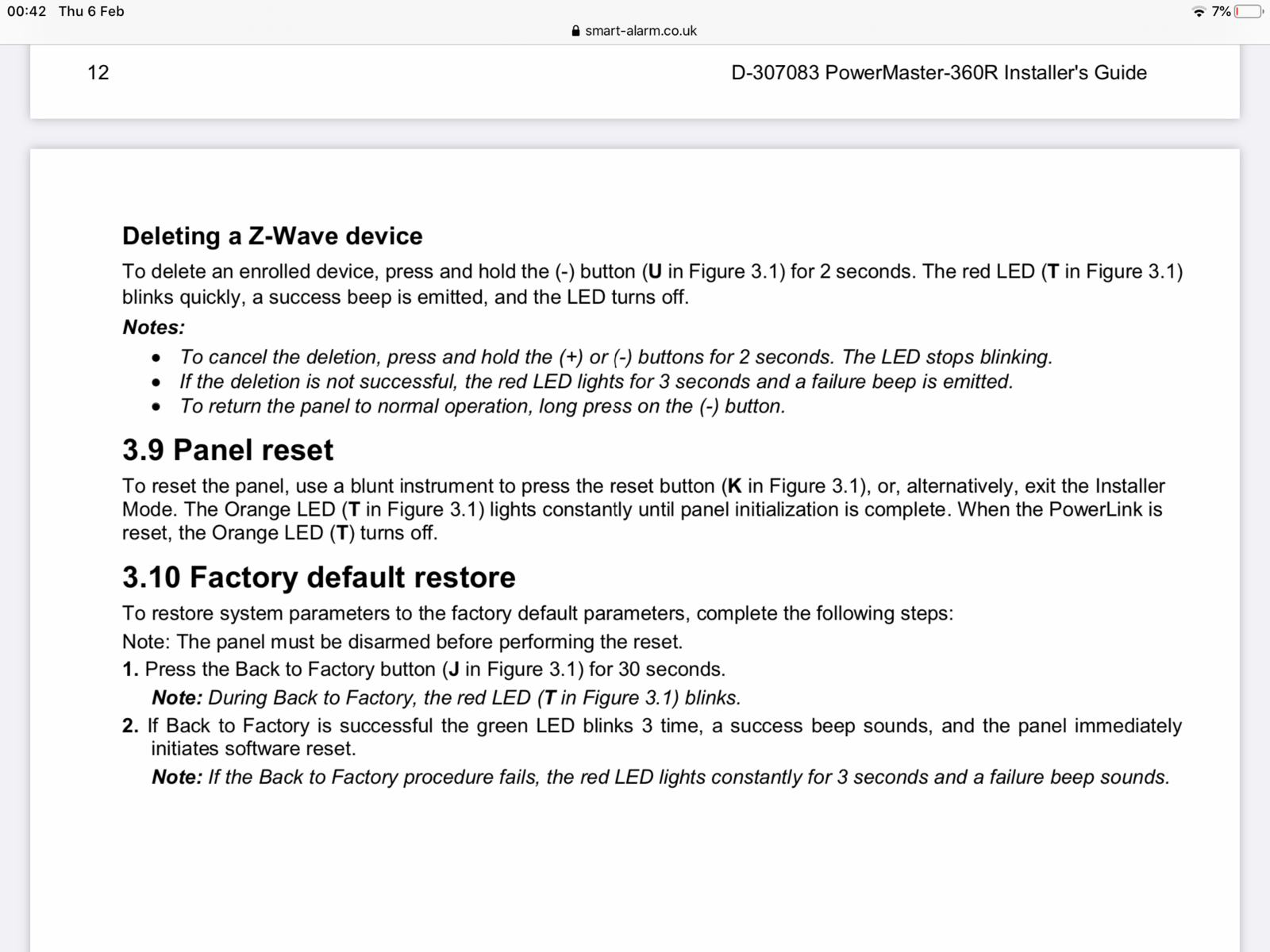

Hello,
I have just bought an second hand ADT 360R alarm panel along with a series of ADT devices. I am unable to get into the Installer Mode because it requires a pin code. Does anyone have any advice on how I might be able to get the code in order to set up my alarm?
Many Thanks
