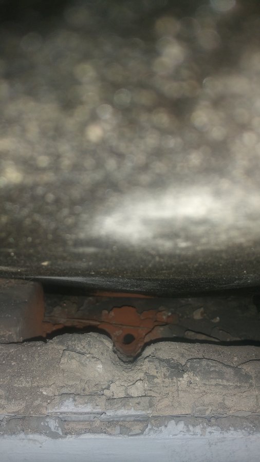

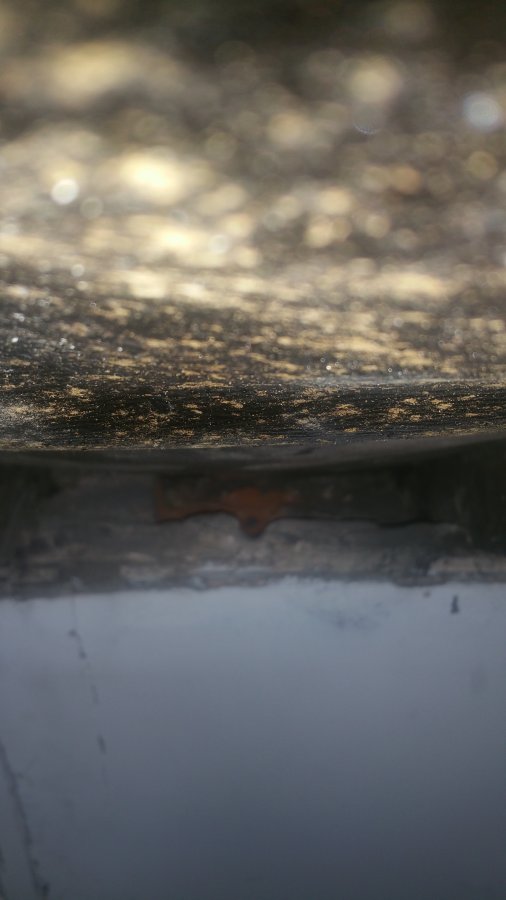

I'm not clear where you are drilling these 16mm holes. If you have old-style impervious roofing felt, then you should be providing ventilation at the eaves and at the ridge, if it isn't present, so air can flow.

The holes I've drilled are where the external brick wall meets the roof. I was originally hoping to put holes in the wall plate but it's external and not accessible, so this was the next best thing. I'm just hoping 16mm will allow enough airflow. I read somewhere that 50mm gap is advised, so wasnt sure whether to redo the hole to 25mm and drill another one. I've attached some pics (apologies for the poor quality).
