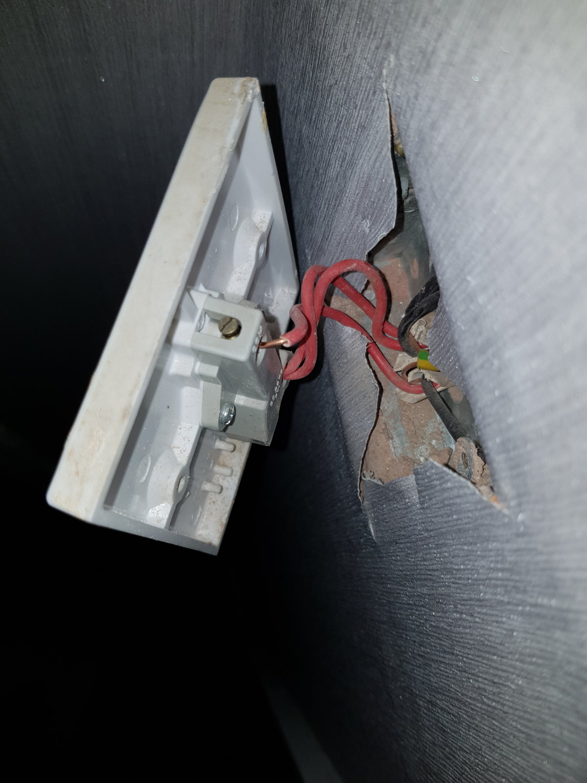

HI both,
I've got a pic of how the dining room was before i made the change... i didnt take a pic of the living room as thought its only 2 and both are the same colour so taking a pic i didnt think would help.
But the dining room, only has 1 switch. See pic of the old set up of the dining room, which shows both the wires connected to the non COM port.... do you guys think i should change this on the new switch in the dining room and put both those into L1, currently i'm sure i put 1 in L1 and 1 in L2.
Other than these 2 light switches no i didnt work on any others, worked on sockets and tested each one as i changed them around.

Exactly as I thought. The two conductors that are in the same terminal in your pic ,should go together in the com terminal in your new switch. The third goes to L1.
By the way the old switch is wired incorrectly ,but would still have worked fine ,along with the others.
Thanks, So the old set up in the dining room pic shows as 1 wire in COM and 2 in the other.
Should i wire the new switch like so the 2 wires which are visible in the pic which were in L1 move them both to COM... and the 1 visible in COM move that to L1?
I'm sure the way i did it in the dining room was, the one i removed from COM i put in COM, and the other 2 from L1 i put in L1 and L2.
WOW if this is the problem i would never had even thought about looking at a room which is working!
Com is the terminal that contains the permanent line( or lines if more than one). When you switch it on ,you connect com to L1 ( internally). When switched off ,com is connected to L2.
So the conductors in L1 and L2 never connect to each other.
Yes
