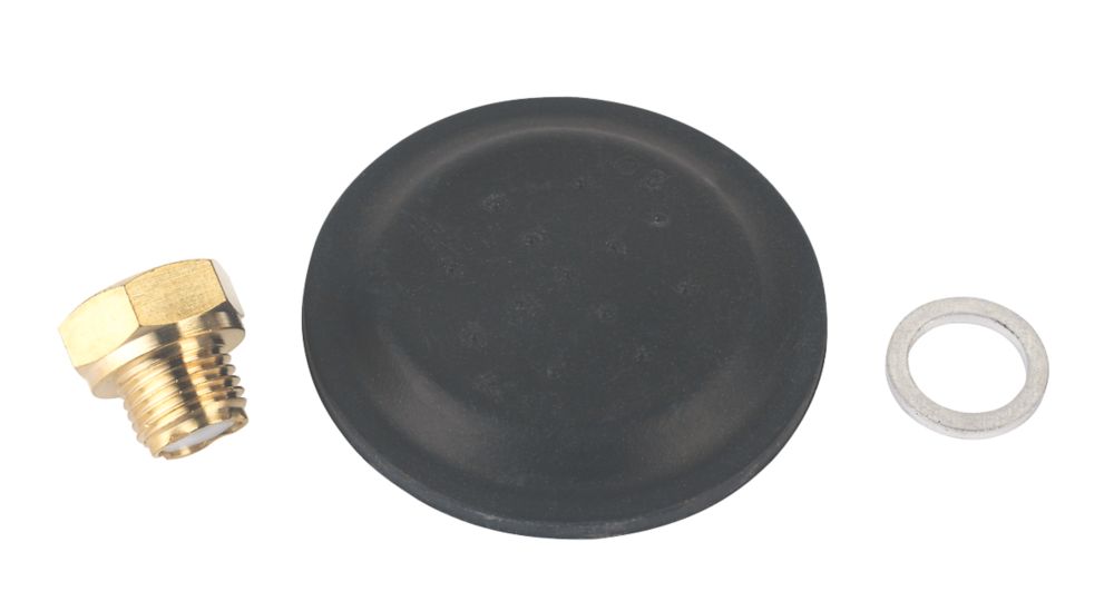

Alpha 240E diverter valve leaks only when there is a demand for DHW. do we need to replace the whole valve or just the front part of it (DHW flow valve)
It looks similar to whats been used in other boilers made by Gianonni (I think) this kit is what you should need and this thread should help with the repair
Chris, many thanks for the speedy reply, yes it is the same one.

no, it is the opposite side
look at this thread its the same bits required and contains advice re changing
