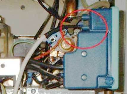

Okay, here are some pictures:
This one shows the white cable coming out of the control unit. The red ring shows how it connects for some reason into the ignition module.
Notice how excessively long the cable is, suggesting it was not meant to plug in there (there's about another meter length of it dangling down outside of the picture).

So, from what I can see, I seem to have the right cable as mentioned in the instructions, but the boiler will not fire if I remove it from the ignition module.

Just to add, when the boiler is on, that cable is actually live with 240v. Weird as the cores are very small and the other end into the spark unit just has a blanked off spade connector with black sheathing over it.
Are the terminals on the inition module just somewhere to "park" and short the connectors on the end of the white cable?

Have a look at the ignition module - you may find the two terminals just short together and don't have any connection with the module circuit.

Yeah good point, could be just a parking place for the connectors. There are two connection points on the ignition module labelled "spark". It will only ignite the boiler when the white cable is plugged into the bottom one. If you look at the first picture, you can see the two connectors on the unit. There's another one in the background, but this is for the flame sensor.

When the white cable is parked in the ignition module, could it be artificially providing an earth or a supply to the unit, and making it function properly, but in actual fact, there is a cable missing. Hence, when I remove the white cable, the ignition module fails to function properly?

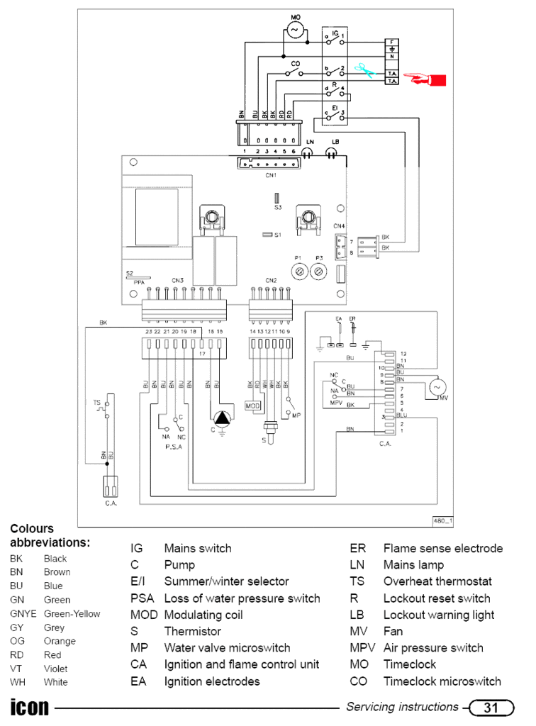

LIke I said, the thermostat has in effect to be in series with the clock, so the ignition and CONTROL box as it's called, is the right place. Not sure if you can connect to the were the T.A> treminals are shown. If not, you can cut into the wire shown, anywhere along it.
The wires inside the white flex are both black.
So from your wiring diagram, the T.A terminal should be bridged at the moment then and I need to run a separate cable to use these two terminals?

The wire with the black plug connects here, which corresponds to terminal 3 on the connector block, from your wiring diagram.
The wire with the blue plug connects here, corresponding to the wire you say to cut.

Managed to get it running this afternoon. Wired it in using a length of 4-core flex - tapping off the boiler's main supply and connecting the the two switched terminals between the black wire with blue plug on.

One last thing, I noticed this on the wiring diagram (circled)
Notice how ignition control unit should have 3 connections - Ignition Electrode, Flame Sensor and EARTH.
So I bet the control unit was getting an earth via the PCB. What I should have done was connect up an earth to the free terminal the white cable was parked in, then the unit should have fired the boiler up properly and I could have used the nice long white cable.
