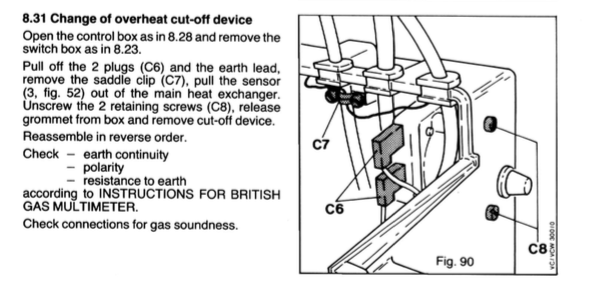

OK, can't see a reset??? and nothing referred to in the manual. it just describes how to change it
the overheat re set is the black rubber tit in the middle of the two screws C8
Thanks just found it as you posted. Sadly nothing doing... thinking the vibration taking up the concrete around the pipes has upset things properly.
As I recall you cannot access that without removing the cover which is not a DIY job.
