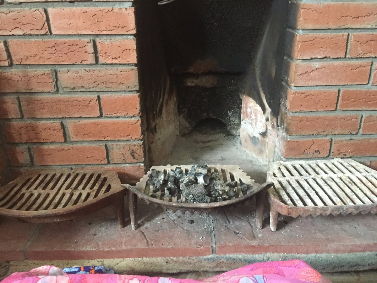

Ok, now for the next puzzle. I've just got the old grate out but it seems to be same height as the one we've been using. Other half said this one that he'd put in was taller. So the weird thing is why isn't that one giving us the hot water that the other one was?
Picture of the three (I found another one too :D). The middle one is the one that doesn't give us hot water, the straight one on the right does and I don't know about the curved one on the left.

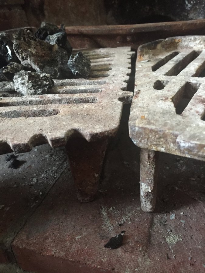

But with the exception of the front bit the height at the back is the same for the middle and right ones (see picture). However the new one I've found is fractionally lower than both so I'm going to give that one a try.

I think you are just a victim of circumstances, Caroline.....to me, all of those grates look a little on the high side but if you can get the fire drawing through that arch, you'll get hot water right enough. The passage from the arch, around the back of the boiler must be clear for this to happen-naturally, - and its not uncommon for it to be blocked with soot after sweeping, or any other debris that may have fallen from the chimney. I get in there with a vacuum cleaner hose minus nozzle to clean these areas out.
A smoke candle (available from plumbers merchants and so on) quickly shows up where the chimney is drawing, and where its not.

I'm going to try this slightly lower (about just over 1cm lower) grate to see what happens. Then next time I'm out shopping go get a really low one (I saw one the other day :D) and a smoke candle. Although I'm busy watching the smoke from the fire at the moment to see what difference opening and closing the damper makes. I must admit to not really seeing anything.
I'll see how this grate does, and the lower one when I get it, if still a problem I might get my sweep out to come and have a look.

Any of these grates are too high Caroline. Take a grinder to the legs of one & reduce the height. As long as you can get a wee metal shovel in to take the ashes out from under it you'll be fine.
Check that the flue way is clear up the back, as said above. Get that slot filled in, it look like a vain attempt by someone to get hot water?! All the above advice is good......Oh, must dash I think I've got a bite on Tinder!!

Update for you all. We've got hot water (y)(y)
Other half is reluctant to accept I was right :rolleyes:
