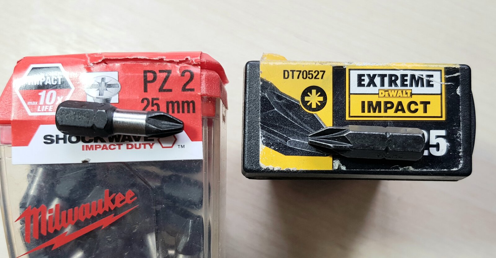

Before that I had these Milwaukee bits, and they are crap - they snap readily and are slightly rounded and don't have the extra fins that a PZ bit should have so don't grip well. They are my loaner bits. :sneaky:
I bought the milwaukee impact bits in the "puck" case, which is a handy little organiser to keep them in. They look different to the milwaukee bits in the photo above. Refill the puck case with milwaukee bits bought on ebay.
