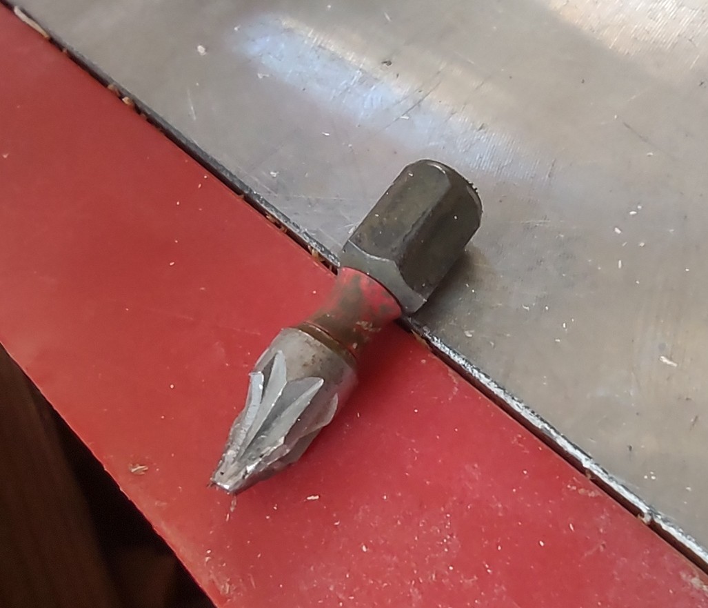

Another Milwaukee bites the dust. I have never managed to round one of these off. Maybe I have a dodgy batch.
I used to think Milwaukee tools were good quality. They tend to be always more expenisive than others. But quality?
The one in the pic shows brittle fracture damage, not wear. The bits for power tools are extra hard to resist wear, but must be a tight fit in the workpiece, not rattling about.
Is there any chance it could have been incorrect size, or a Pozi/Phillips mismatch?
