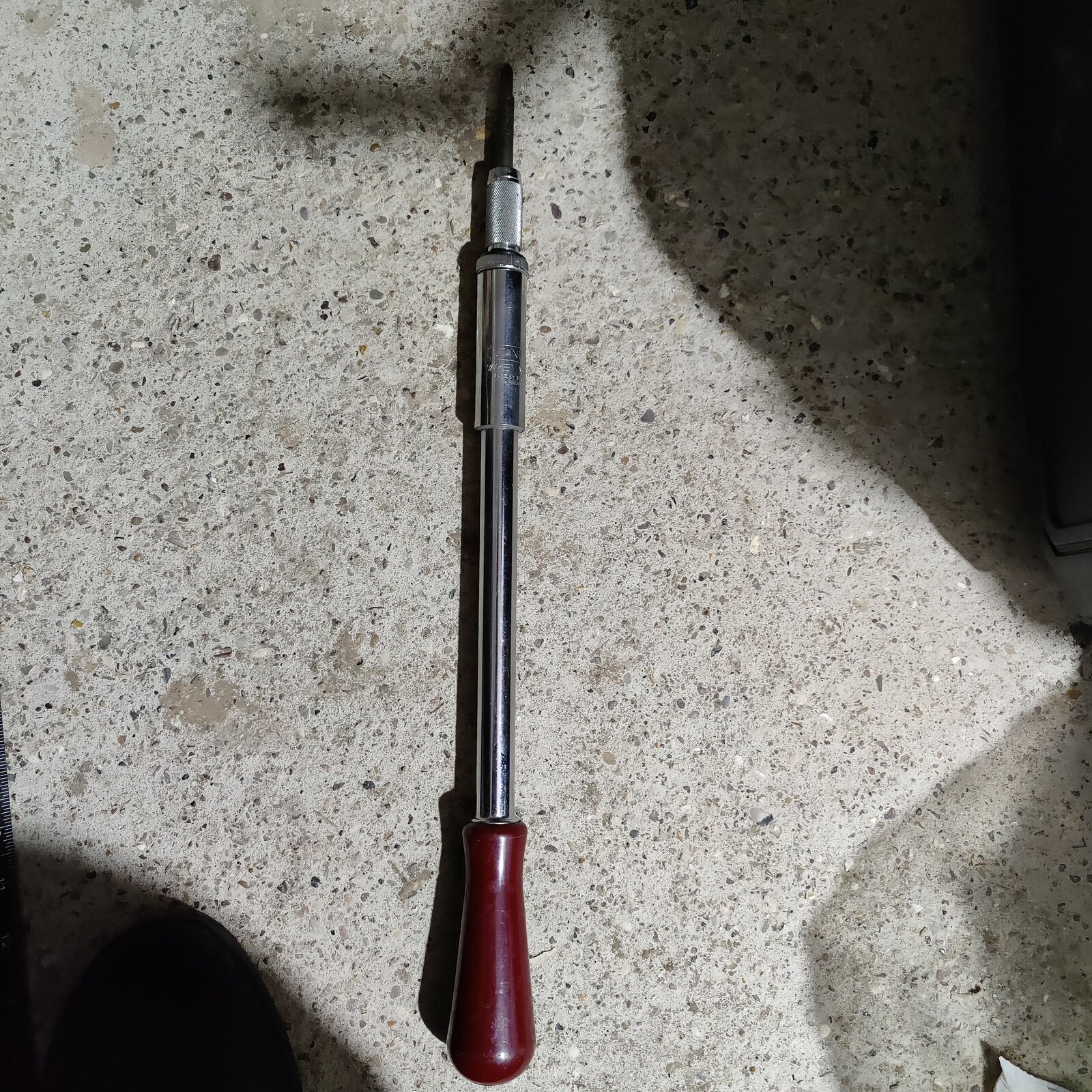

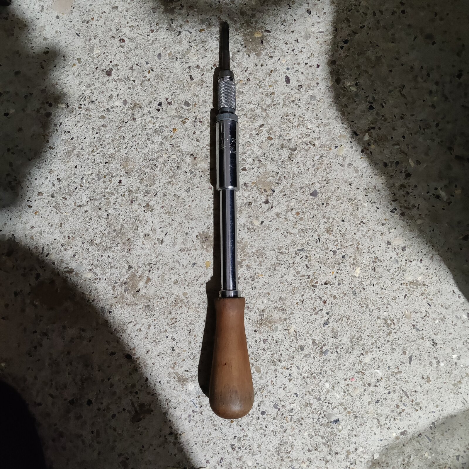

I was also looking for a long pozi2 driver.
Our local ironmongers sells CK long PZD#1, #2 and #3. They are German made and has a transparent red/orange handle. Maybe worth looking for, but they are only about 300mm. Beyond that use hex drive bit holders and Wera impact driver bits
Or have a look on Ebay for Yankee screwdrivers, if you do just watch your pinkies, they extend and are sprung and can make holes in limbs if not treated with respect.
