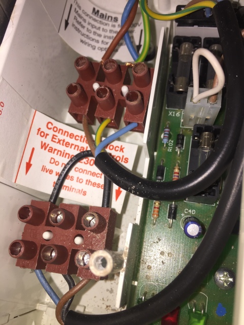

Can u help me
I've got biasi combi boiler and connected room thermostat yesterday everything working good but when I turn on the heating flashing first light green and second red but heating is working and hot water aswell when heating is on and i turn on the tap with hot water red is gone and flashing first and second green. When heating is off on boiler flashing green first light

It's a biasi riva advance he m110b 32sm/c

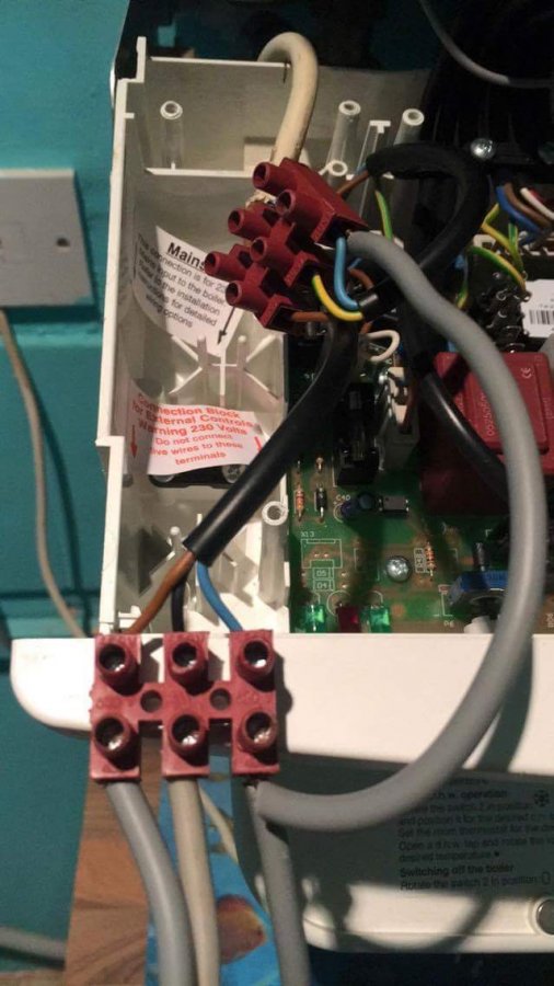

Just i'm not sure if everything is ok after room thermostat connected when i was using a boiler without thermostat on was first and third light on but now when thermostat is connected when i turn on the heating i've got first green flashing and second red flashing together but boiler working fine heating and hot water
I am surprised that it is still working fine.
You have somehow wrongly connected the thermostat!

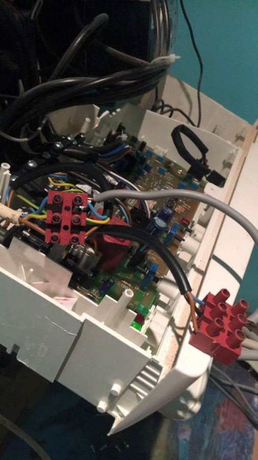

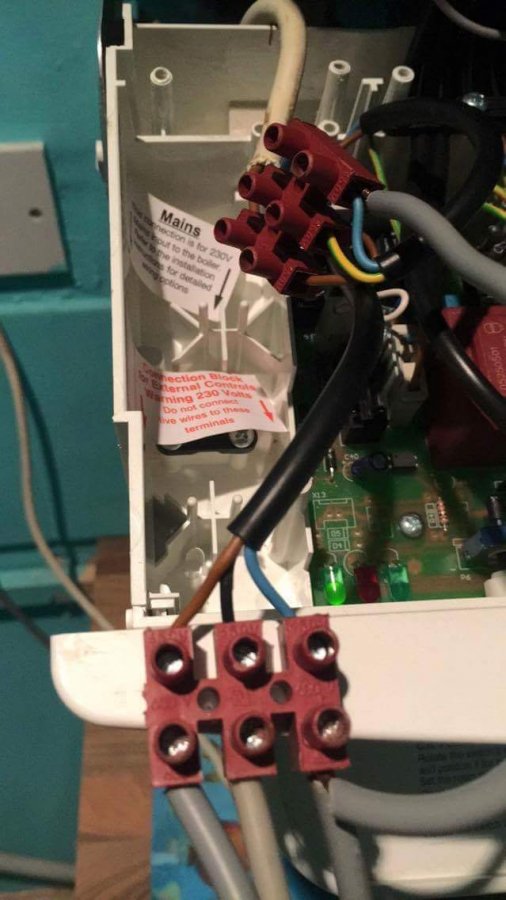

image.jpeg image.jpeg image.jpeg So how this supposed to be connected?
But there is nothing connected to the boiler!
You said you have already connected it?
Yes but i'm not in home now i'll do the pictures after 9 pm

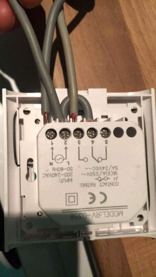

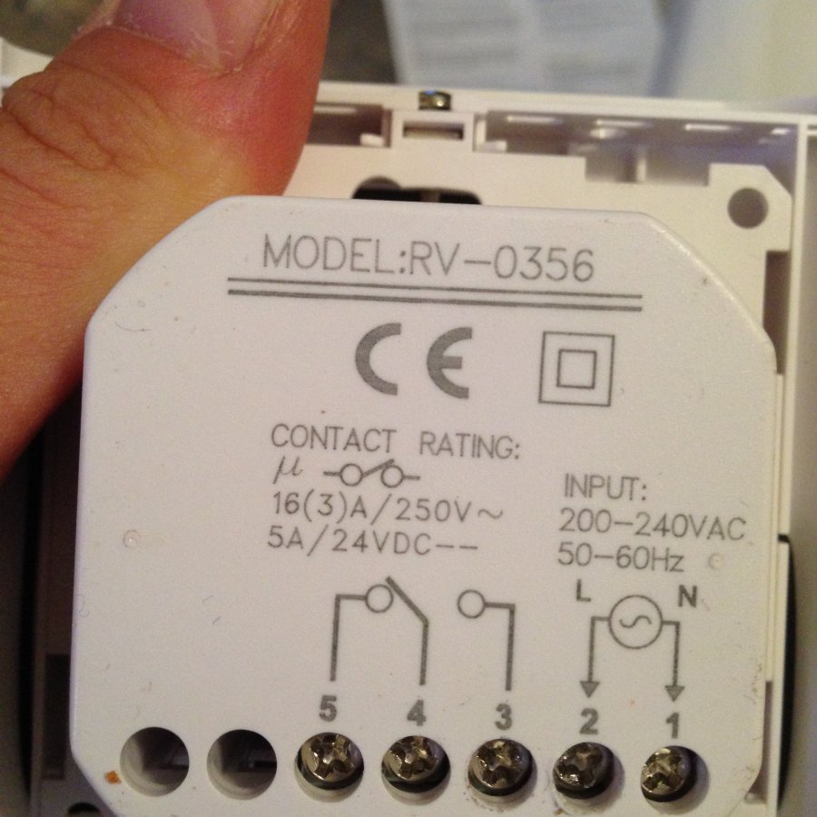

So neutrai from thermostat 1 is connected into neutral in terminal 2 and terminal 1 L from thermostat link with nr 4 and connected into terminal 2 with L and last one 3 (NO) is connected with terminal 2 middle with black
I cannot easily guess what you have done.

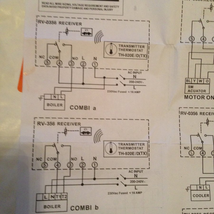

But you only need two wires from the stat to the boiler!
Connected to 3 and 4 on your stat but with NO other connections at the stat or boiler.
Done wrongly can damage the PCB.
Tony
Only 2 wires ? 3 and 4 what next ? Where 3 is going what about 4 ? What about 1/2 L and N
