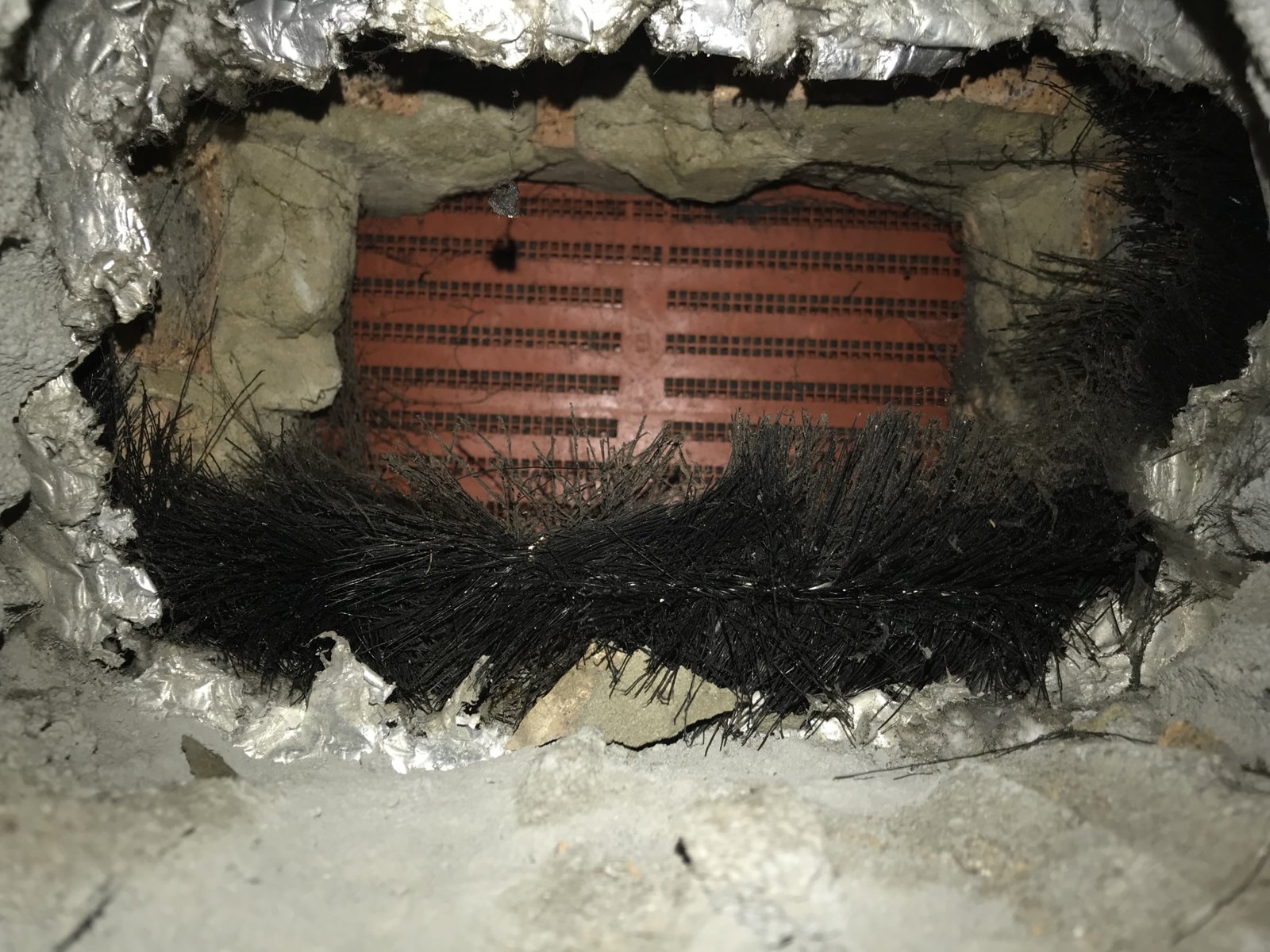

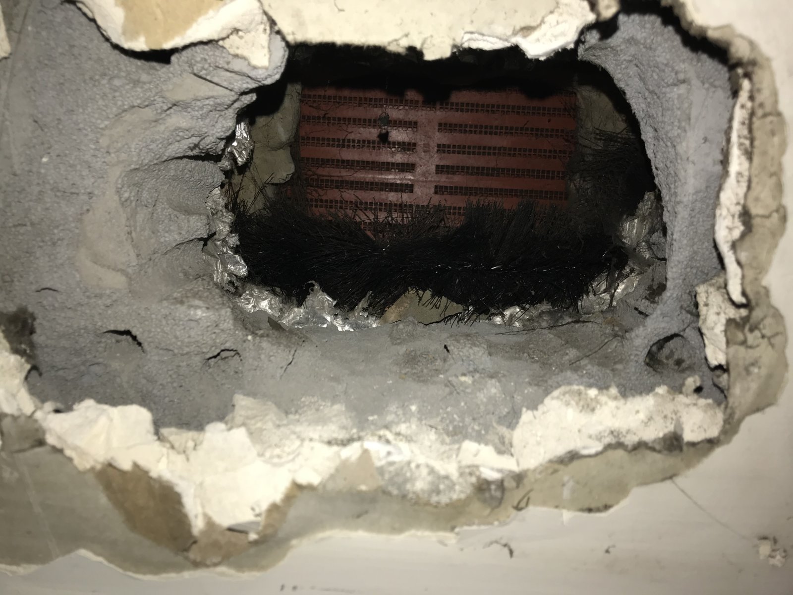

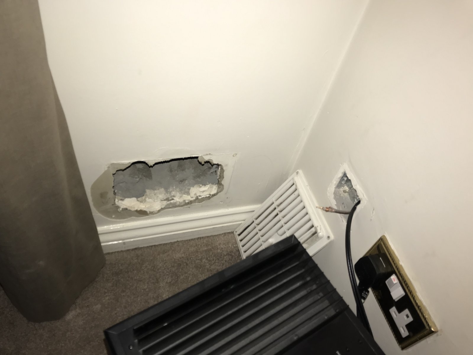

We’ve had a gas fire removed, and am wondering what an effective way to block up the massive draughty vent through the cavity wall, at least on the interior for now. House is ~17yrs old.
6E76EE0C-F2A2-4A06-8E41-3B0B30520E8B.jpeg F8AEB9EB-418A-4060-9F23-C6E478B8901F.jpeg 445B6E56-DF00-49BF-9AFD-FE3370D67D4D.jpeg
I was thinking expanding foam, trimmed then topped off with plasterboard or plaster/filler?
Don’t want to allow damp in.
Any advice appreciated!
If it goes to the cavity then just seal it how ever you want - cement. You should not have vents from inside to the cavity.
Was there also a flue for the fire? It appears to be in a strange location?
