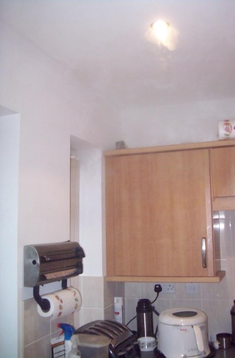

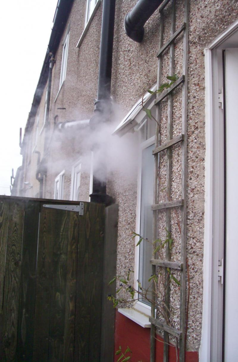

Well I do sort of suspect that POC might just be entering my kitchen....
These were taken about a month ago, when the wind was blowing directly from the West...

From looking at those 2 pictures of the flue gases entering through the window it would be hard for anyone to dispute that you do have a genuine cause for concern. (However it seems the installer has done his duty in following the mi's). So he cannot be blamed. As dan says your next port of call should be gas safe. Goid luck with it all.

I cannot interpret the pictures as none seem to show the flue, the boundary and your window. That's in one picture.

Thanks, but it's parallel to the boundary, not facing it, so 300mm in this case (I think.)
View media item 74987
Right then in that case the edge of the flue should be 300 mm.
That's usually taken to be the MIDDLE of a party wall between properties.
BUT in addition to the statutory distances a flue also has to be fitted in a location "where it does not cause any nuisance".
