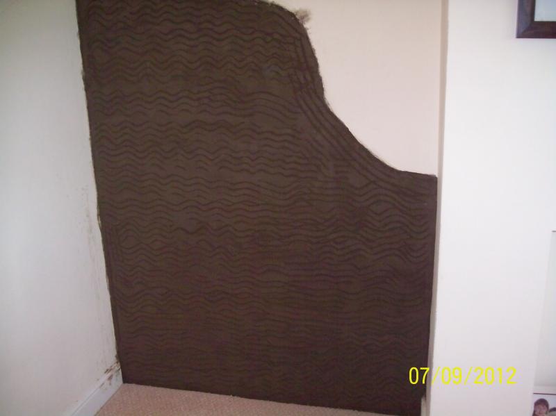

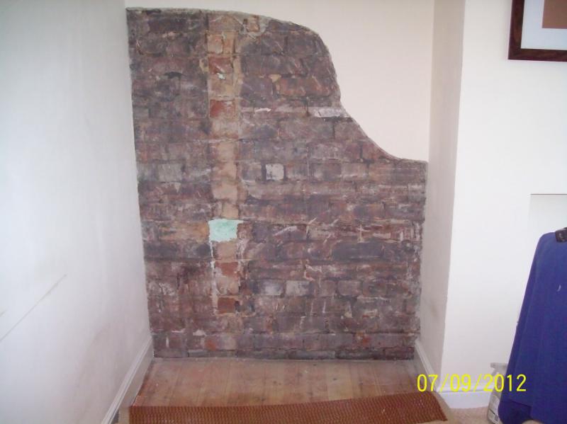

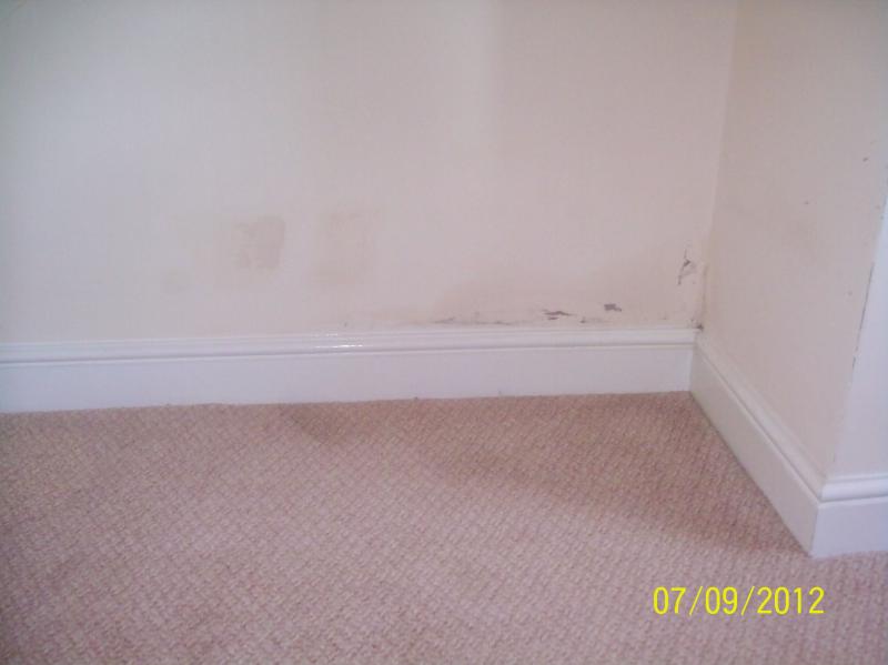

Now I can chase him for the £600 I billed him for when his useless DIY skills led to him buggering up his water service pipe just before the stop tap - which caused no end of damage to my plaster and carpet. He just left it running for weeks (after taking up a few floorboards to let it run away under the floor,) but it was spraying the party wall and I only noticed it when my wife lost something behind the cupboard we keep in that corner. The wall was saturated, the carpet stained, the MDF skirting swelled to twice it's normal depth.

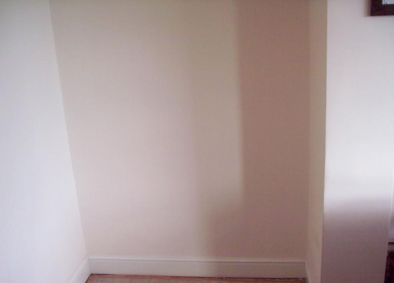

Had to have the plaster hacked off, some of the boards taken up (to make sure the joist ends were still OK,) treat them with preservative, render scratch coat then limelite and finally skimmed. After it was decorated, another £250 for a new carpet.

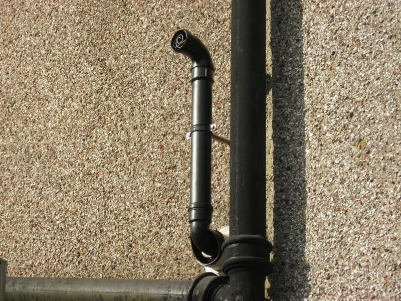

He promised to put his findings in writing, but he also said he'd be making a couple of phone calls - and I assume one of them was to the installer. We returned from our hols on the 16th, but there was no letter. But when I looked outside today - this is what I saw....
That does not alter the flue being 125 mm from boundary.
But it does address the POC getting into your window.
Well done!
For once Gas-Safe have done something useful.
