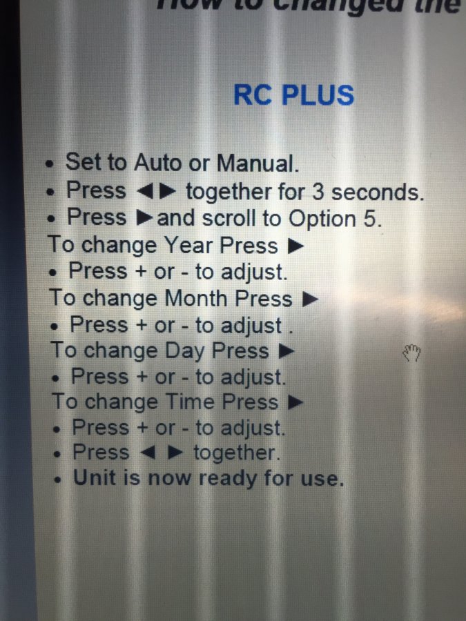

i have a brisitsh gas rc plus (drayton digistat) and im having problems setting the date and time on the thermostat.
I have followed the instructions on the user guides etc by pressing the > to run through to 6 programs but once I have done that I cant access the clock to amend the date and time, the thermostat just reverts to the next option which is holiday mode. So basically every time I run through the options it skips the clock.
Is there any other way to reset the clock because at the moment I can not set the heating to come on automatically as the date and time are so far out?

Did you ever work out how to fix this as I have exactly the same problem. Followed instructions in manual and it always skips past the clock icon!

You cant access the clock, if its wrong it needs replacing. Strange but true.
Thanks very much for your answer - just what I needed.
