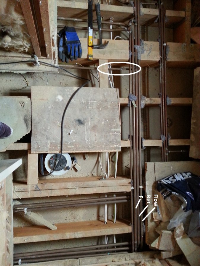

I've attached a pic in case what it shows makes the situation obvious to anyone.
Flow, Ret, and F are written on the pipes, all three of which come out from under the HW tank.
The circled 15mm teeing off the 22mm is the one that pasess under the rad. (It's tee'd to the Ret)
Thanks again guys
The circled 15mm teeing off the 22mm is the one that passes under the rad. (It's tee'd to the Ret)
F is possibly the cold feed to the two tanks in the loft.
So one end of the pipe is tee'd into the return; where is the other end connected to? If it's to the same pipe but further along, you have a single pipe. If it's to a different pipe, which connects to the Flow pipe, you have a two pipe.

Daniel - It goes back into the same pipe it came out of.
Kev & Daniel - Fired things up again and the pipe does get hot with the hot water on.
