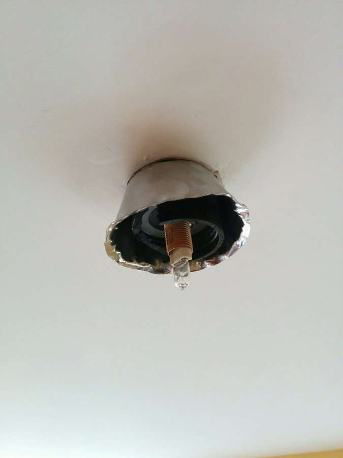

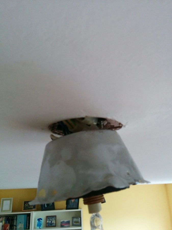

Can't remove light fixture

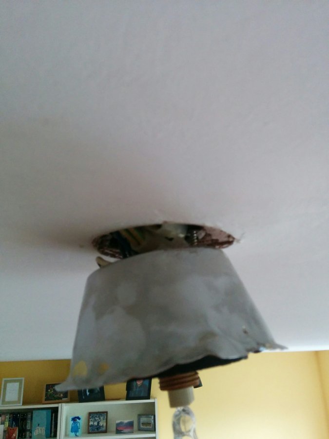

Ok. Well the room is well lit, so the light is not critical.
I like the super glue idea. I am thinking that if i take something the strength and shape of a tape measure, glue it on, and then grab and rotate, it might work. Otherwise I think smashy smashy might be the answer. But
OK.
Well, the fixture has been removed. I didn't need to smashy smashy, but I did have to trash the light fixture.

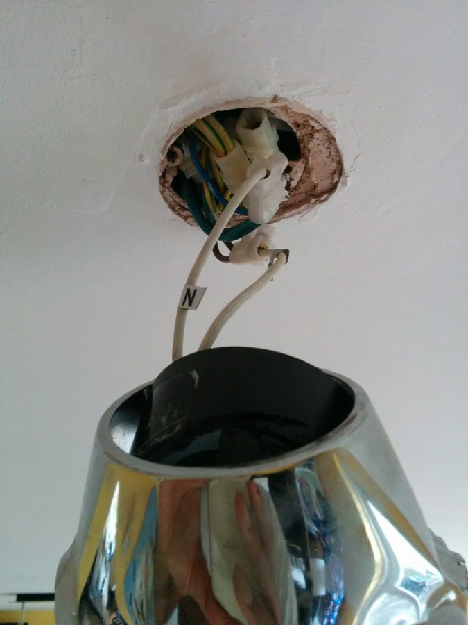

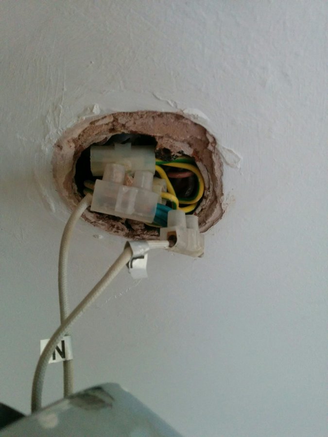

I have now purchased a new light fixture. I have a new question now. Pictured is what remains of the old fixture. there is one screw holding it to SOMETHING. Can you tell me from the pictures if what it is screwed to is part of the fixture, or is that the mounting onto which I would mount the new fixture? it looks like an awful lot of wires, so I thought that was internal to the fixture.
I am trying to decide if I need an electrician.

I'm not quite sure what is wrong, but basically you need to turn off the main fuse box, unscrew the terminals holding the white wires in, attach the new fitting to the ceiling, and screw the wires of the new fitting in their place Matching L with brown and N with blue as appropriate. If the fitting has an earth or e then connect to the stripy green and yellow terminals in the ceiling. While you're at it ideally you'd put the terminal blocks in a proper enclosure, but as a minimum it'd be good to wrap them in electrical tape to avoid shorts.
The screw is attaching what's left of the light fitting to the ceiling. There is no 'mounting' - it's just the ceiling.
Those wires and connectors are part of the building wiring, and really should be pulled out of the ceiling to see exactly what has been done there. However at least some of those wires may be live even with the light turned off, and disconnecting any of them is likely to result in other lights in other rooms not working.
Probably.
