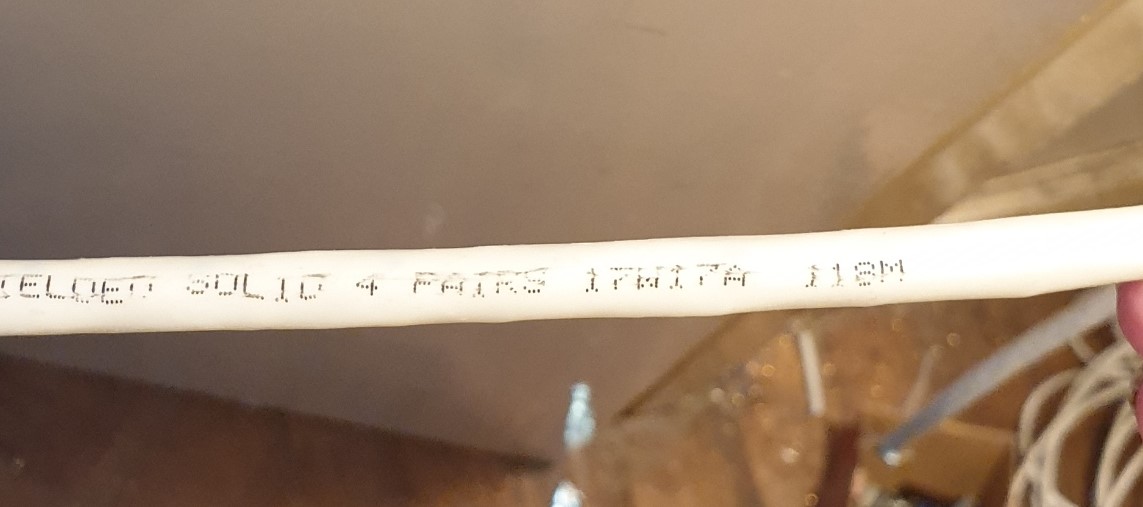

Anywho- a regular customer asked me to fit a network switch in the cupboard under his stairs.When he had the house re-wired last year he asked the electricians to run cat 6 shielded cable to each of the rooms.
I have only ever worked with cat5e previously.
Today was a mare, I kept finding that as I tried to feed the cables in to the the plastic Cat 6 plugs that he has, they would deform and the brown cable at the end would not feed in. I suspect that the gauge of the cable is a tad too fat for the plugs.
Below is a photo of the cable .
I guess I need the shielded plugs with the insert, but would be happy to accept recommendations. The existing plugs are no good- I can't get the sleeve to push in and if I do the brown/white and brown keep distorting.

I do however appreciate your collective responses. After some (novice) research, I think I need to order the shielded plugs with the cable guiding inserts (ie 2 part). I am however willing to accept further advice from anyone that has worked with thick gauge shielded cat6.I would rather just put the RJ45s on and sign off.
